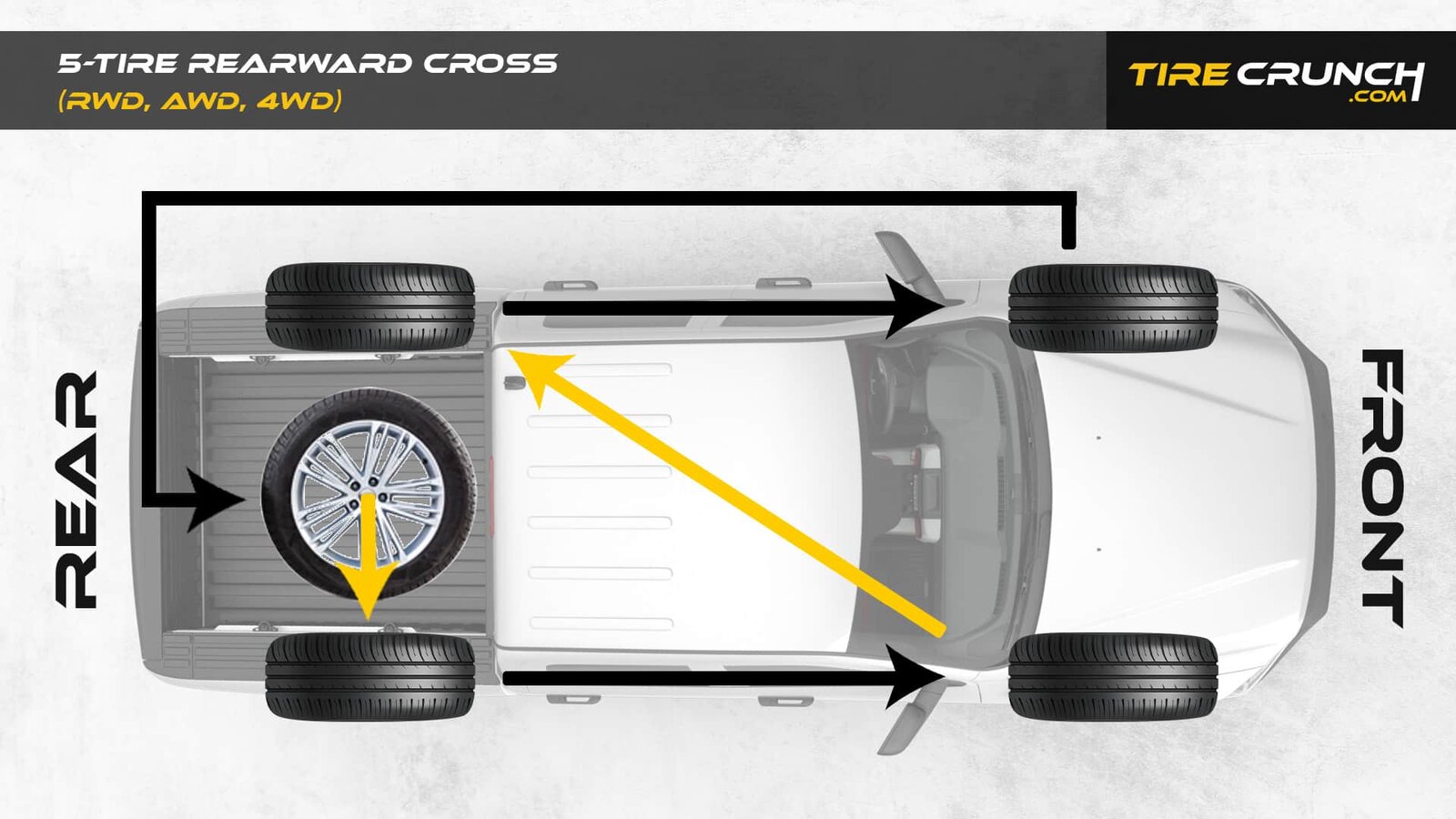

I was planning on the rearward cross like this diagram:

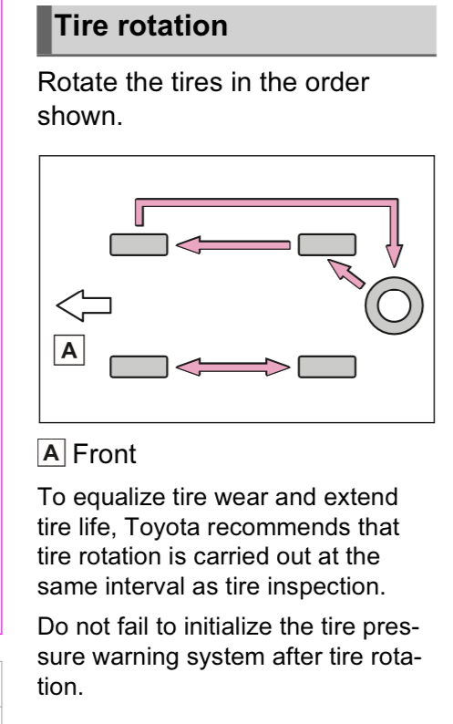

I found this from the LC100 manual. So many different variations that it's confusing:

I’ve always crossed and done 5 tire. As long as you’re consistent it shouldn’t have a massively different impact.
Personally I choose 5 tire because I never know if I’m going with the same brand/tread etc tire, and I have my spare typically on the rear door. Makes it so I replace all 5 at the same time and not wasting a brand new tire to cater to my OCD having them match.

if you have a matching set of 5, there is zero reason to a 4 tire rotation. Tires have a lifespan, even if they have 0 miles, and you should replace your spare tire at the same time, you might as well get some life out of it. I don't know why anyone would be adamant on keeping them rotating the same direction, unless of coarse they are directional tires.
