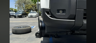

Well, I think I may be the first to officially mount 17s on the LC 250:
Wheel: fifteen52 Offroad - Analog HD - 17x8 +25
Tire: Falken Rubitrek AT 285/70/R17 (approx. 32.8in)
Got them installed at my Toyota dealer. They had no concerns of tight fit. Balance weights cleared. No rub. Pretty close to the aero attachment on front bumper but clears it at full lock.
*More videos of the setup on my IG: @familycruiser250

Yes, the .5” at +25 made a big difference. Here is the Nomad 8.5” +25. I would have loved the Nomad wheel but didn’t like the aggressive stance especially on stock suspension.
