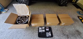

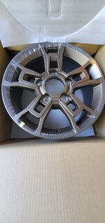

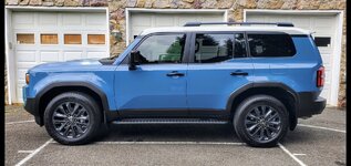

Got the 18" TRD Pro BBS wheels/tires mounted and LOVE IT! Def changed the whole look and much more rugged looking now. Drives just as smooth as the OEM 20s that were on this before. Maybe slightly more road noise than before and MPG impact TBD, but to tell you the truth, don't care. It just looks awesome.
Here are the details, etc.
(5) OEM Toyota TRD PRO 18" BBS Forged wheels on Falken Wildpeak A/T AT3W (285/65r18)
Part #: PT960-34220-2F (18x8.5) (47.5mm)
(20) Genuine OEM Toyota Black Lug Nut Set of LC/Sequoia/Tundra Black Lug Nuts (14mm x 1.5mm)
Part #: PT076-0C200-02
(4) Genuine OEM Toyota Black PVD Alloy Wheel Locks (14mm x 1.5mm)
Part #: PT276-34200-02
*TPMS swapped from OEM wheels
*You can use the OEM lugs. The OEM 20" black chrome lugs use 21mm socket, but the black ones noted above that I am using require a 22mm socket
*The 285/65/18 tire size fits in spare location. No issues

jealous Those look great!
Damn! Looks great! I am thinking of doing this exact set up for my heritage blue LC. Looking at fb marketplace for a set of take offs.

The TRD Pro wheels make it look so much better.I have the same color/trim but with the OEM. 18s. I'll be looking for the TRD pros as well.
Dude this looks so good, and gives you much more capability off road. The stock 20s weren’t going to work for me either.
