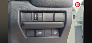

Is there anyway we can connect a physical Wiper de-icer switch from other toyota models to control ON/OFF in here? I was thinking of this Original Toyota Part switch which is same size as the other switches next to the steering column. Anybody know how this can be wired to work?
Thanks
