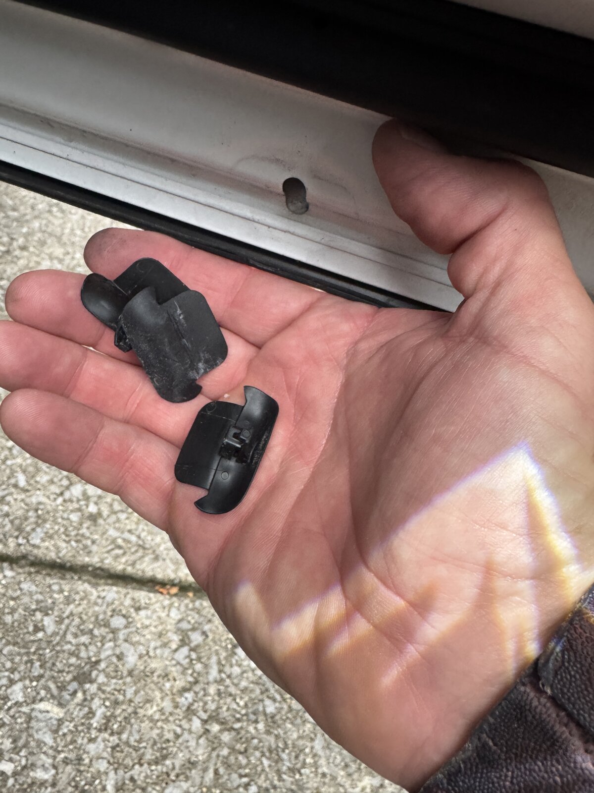

I feel like this may have been discussed before, if so, I apologize, but …
When it rains or I wash my truck, it seems like for 2 days if I roll my windows down and back up, they are covered with a lot of water and obviously dry really streaked. I have had this for a couple hours in other vehicles, but in 90-95 degree heat, I would expect everything to dry pretty quick. Anyone else have this problem or a fix ? And I use a hybrid hydro product on them and it has not helped.
i have noticed this too. Unplug the black plugs at the bottom of the door where water exits, it prevents wind from going into the door. I washed my car yesterday and it no longer streaks this morning.
Do you mean these ? And should I leave out permanently if it helps ?
OK so obviously will let the water drain better, but are you saying that wind goes in there to help dry things as well when vehicle is moving?
Yeap 100%, normally other cars don't have those black plugs, interesting that the LC has it, kind of sketchy to be honest, especially for someone that lives in a rainy area
Thanks. Looking forward to seeing how this works. Just checked my wife’s car and no plugs
