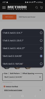

Wanting to upgrade the stock rims on my 1958 to these Method 318 below, but which offset spacing should I get? What is the difference?

What do these options mean as far as the inches etc.?
I don't have any preferences on poke.
I don't understand why anyone would desire for the wheel to tuck further into the wheel well or vice versa. I guess I would want my wheels to sit as close with stock as possible.
The inches measurement is the backspacing - the measure from the mounting point to the back edge of the wheel. You can see it grows with the increase in offset (the mounting point moving from the center of the wheel outward to the outside edge of the wheel).

So if I wanted minimal poke, which of these options am I choosing in that screenshot?

Oh OK. I didn't know which number referred to offset. Much thanks.
No problem. Good luck!
So it appears that a 40 offset won't give that much poke if yours is a 0.
I've gone into detail on this topic in a few places on the forum. The simple answer to your question is to buy the 18 x 8.5 +40 to get a wheel that will work the best with our LC. Changing the offset from the OEM design can have adverse affects on the suspension geometry (here's a great video that helps with the visualization from Tinkerer's Adventure: 4 Tips to Actually Fit Tires on Toyota IFS)
