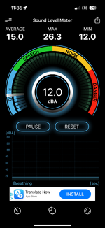

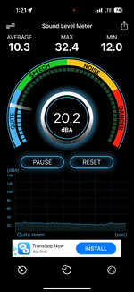

Haven’t had the chance to hit the freeway but at 50 they barely made any noise but I could hear a small amount of additional noise. Driving along the coast with wind max noise was 26 dba and with them it rose to 32 max. That’s still in green area on their scale just above the blue.
I’m sure it will increase at higher speeds and adding the ski rack and then skiis snowboards it continues to get worse, but that’s expected.

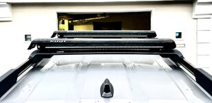

All done, t slots work just fine. It’s not simple to install and it might be easier to remove cross bars with rack attached than just the rack if you need to remove each season…

All done, t slots work just fine. It’s not simple to install and it might be easier to remove cross bars with rack attached than just the rack…
Thanks for the pics! As someone else mentioned, I was curious about the tslot install being wonky with a non-Thule rig as I have heard sometimes presents some snags.
Looks great! Damn those cover pretty much the full width! Looks good though!
The trick is to insert one side in and leave the other out. Then push it enough to get it past the other end and push that back in from opposite side. I think it’s almost impossible to slide the entire thing in from one side to the other.
