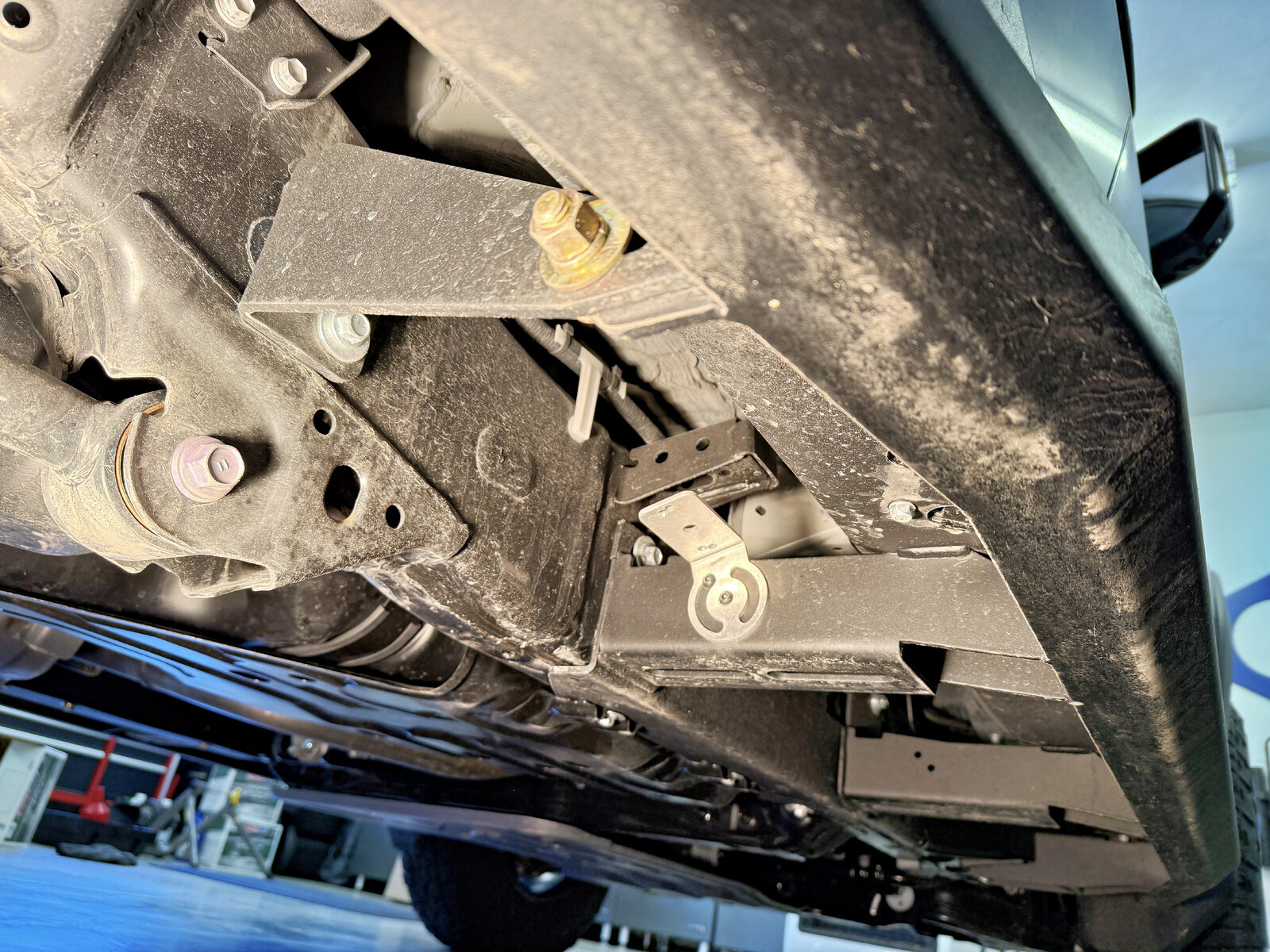

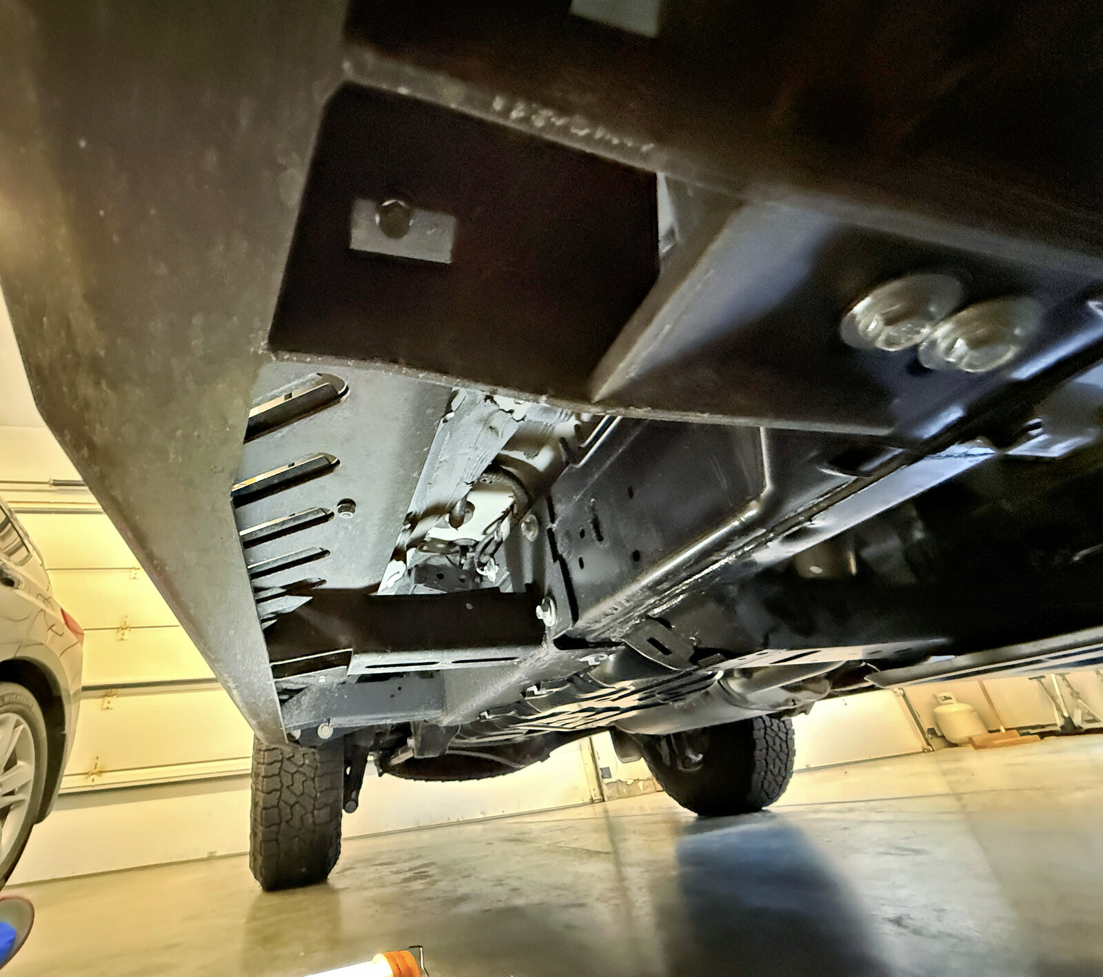

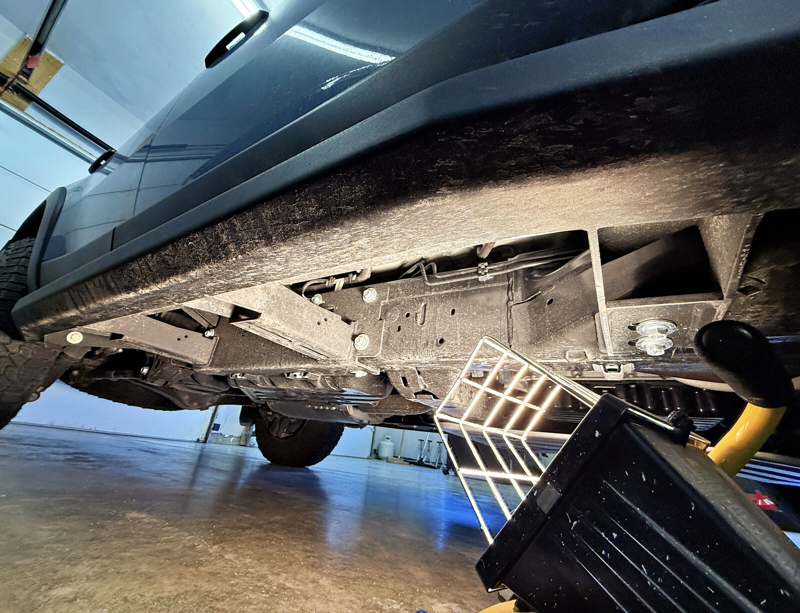

Thanks for the detail information. Can you share a picture of those from underneath.
What would you like to see a picture of? The bracket? The LED light?
Here is a link to the Slee Light Kit
Yes, I'd like to see the general structure under the step, too. I tend to believe a rock slider should be flat, so a rock can, you know, slide and not get caught on tubing or bolts. Thanks in advance.
Here's a few pics.
You can see the light bracket attached to the slider in the bottom picture. I've swung it up until I attach the LED light to it.
