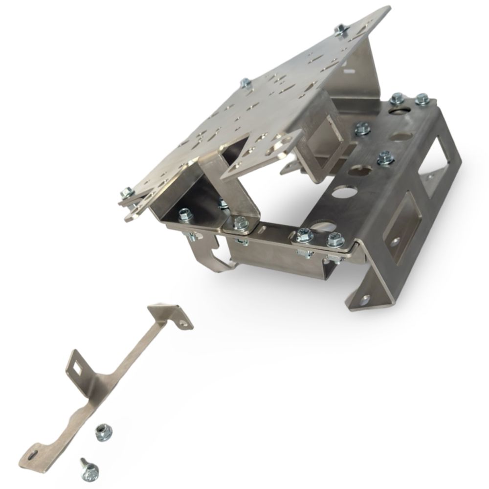

Been waiting for Slee to get this to market, as I wasn't so enamored with the CAtuned mounting location. Definitely a complex piece of bracket (shows how over-priced the relatively simple CAtuned bracket is $375 vs. $300), but I'd much rather have the compressor not buried so that it receives a bit more airflow near the top rather than buried underneath something (the ARB Twin in my 4Runner could get HOT!). Due for install in a couple of weeks. Link below, they also have a bundle with the compressor.

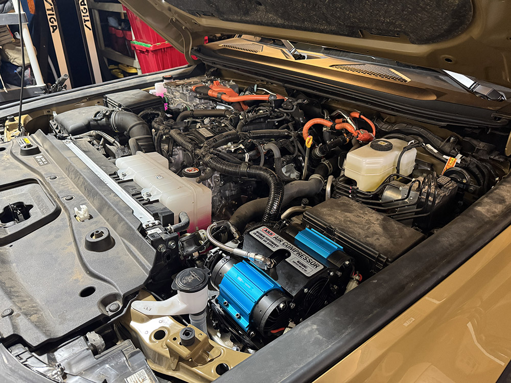

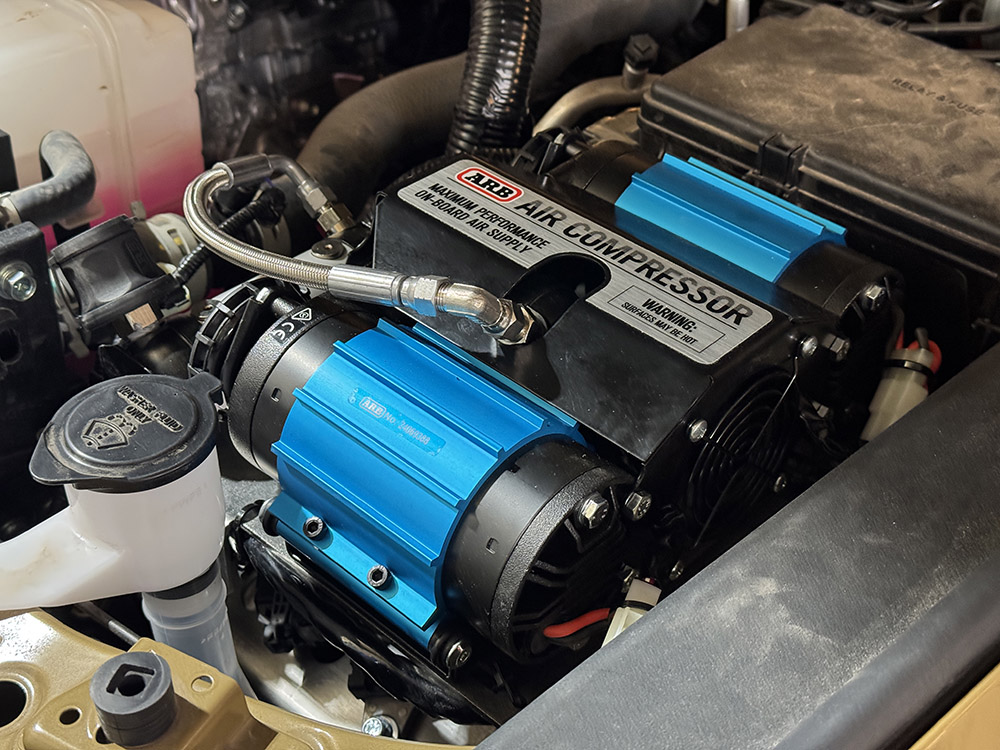

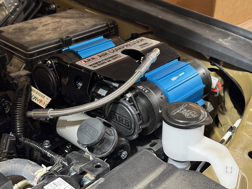

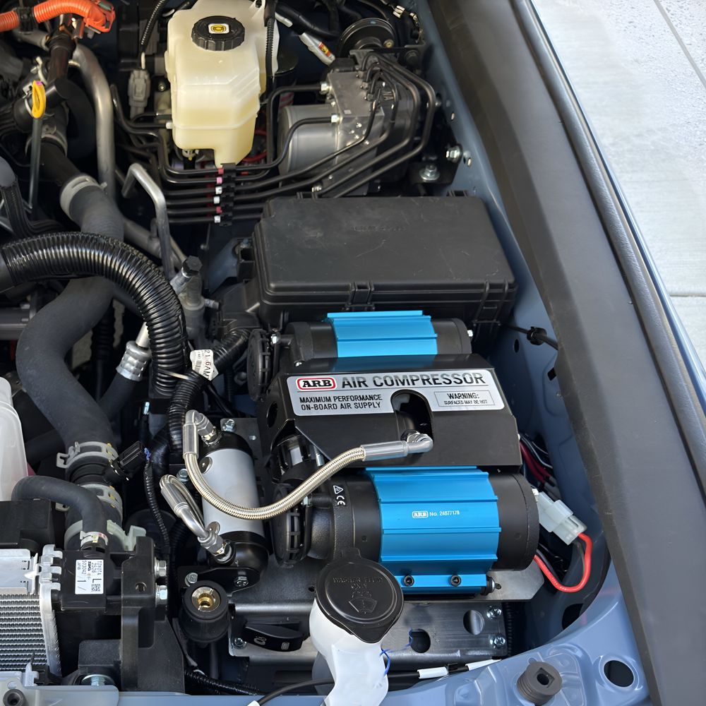

Yesterday Slee installed the ARB Twin in my LC250 using their new bracket, very clean install, and I think much better than the CAtuned option, as this leaves the compressor fully accessible in case something needs attention. They tapped into power under the hood near the vehicle's jump terminals, and interestingly they said they have tested this power source up to 300 amps draw without popping any fuses or affecting any other systems; their impending full winch bumper will likely use this power source rather than having to run from the rear battery.

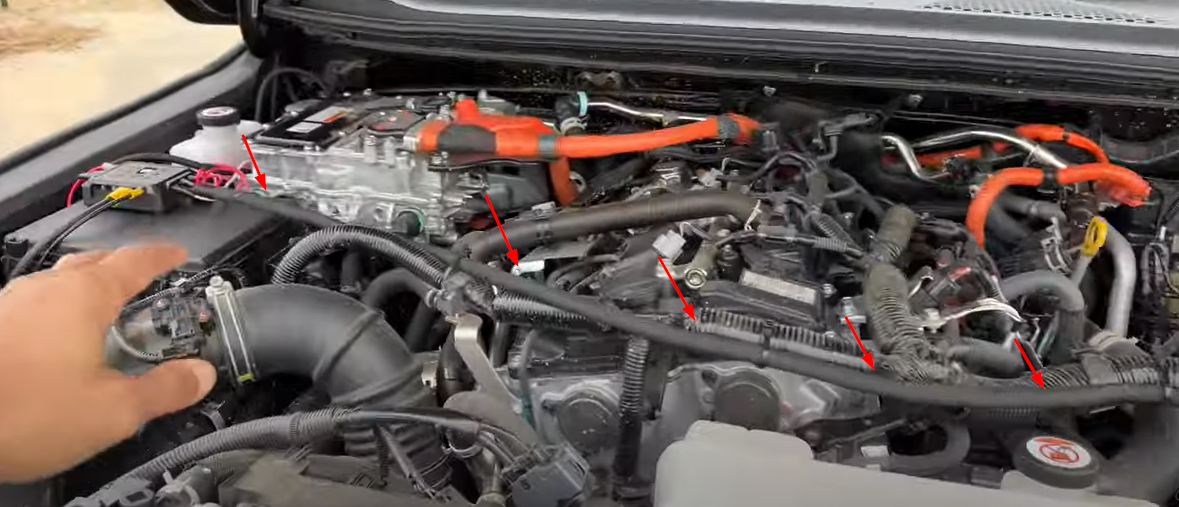

1/ All ACC lights with Auxbeam control panel and air compressor can hook up directly to the jump terminal in engine bay
2/ winch connected directly to the battery in the rear
Can you imagine that at night in the trail, all the ACC lights ON, then you need power to heavy duty 12k lbs winch at the same time…I am pretty sure, we will be in big trouble :)

Looks great! So, it looks like the air compressor was placed right where the computer was located. Where was the computer relocated and how?
The computer is in the bracket. Look at Slee's website.
Underneath the compressor, in a different section of the bracket.

That looks great! Where did you move the computer to? Did you add a switch on the dashboard?
Slee installed it. If you look at the pics of the bracket, there is a lower sort of 'slot', and it fits in there at an angle, but nearly flat. They added a switch in the lower left slot, below-left of steering wheel.

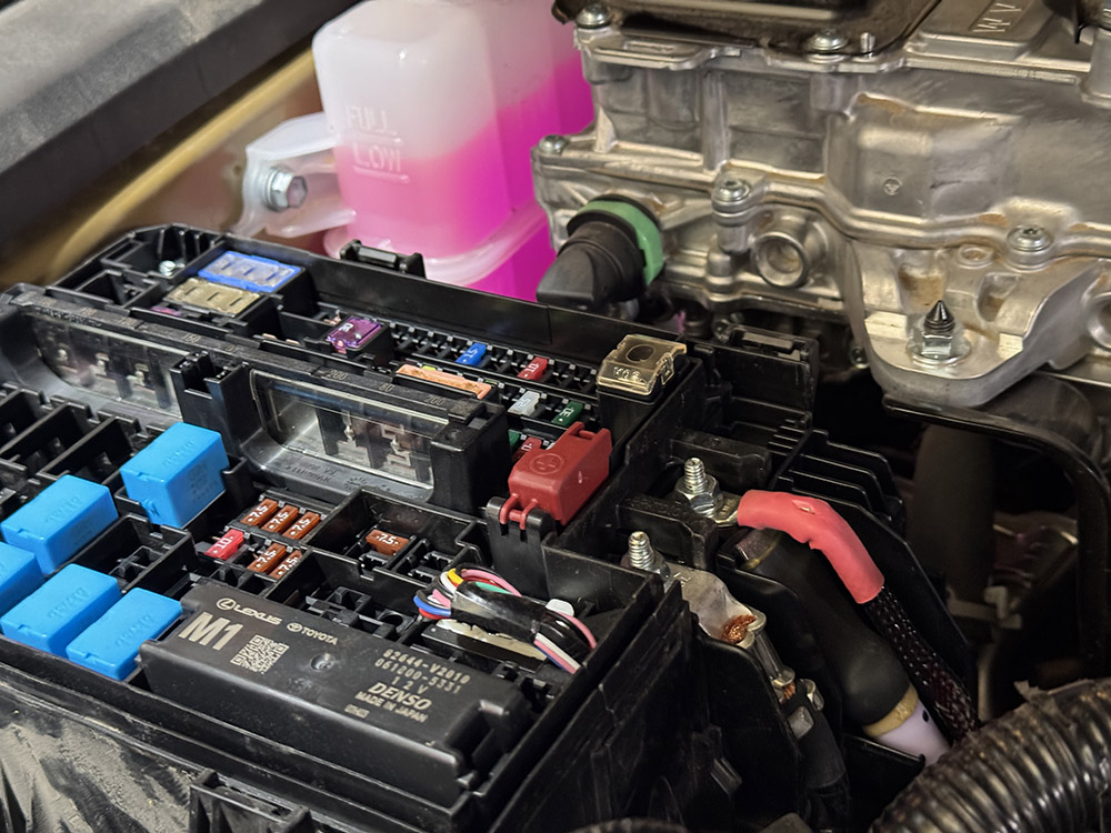

Putting a 300a fuse inline makes good sense (for clarity the fusible link at the 12v battery is 350 amps) which means the 300a should blow before the 350a. Personally, should I ever add a winch, I plan on replacing my existing 60a circuit breaker with a 300 amp circuit breaker vs a fuse.
note: the unused stud beside the 350a link is rated at 200a.
