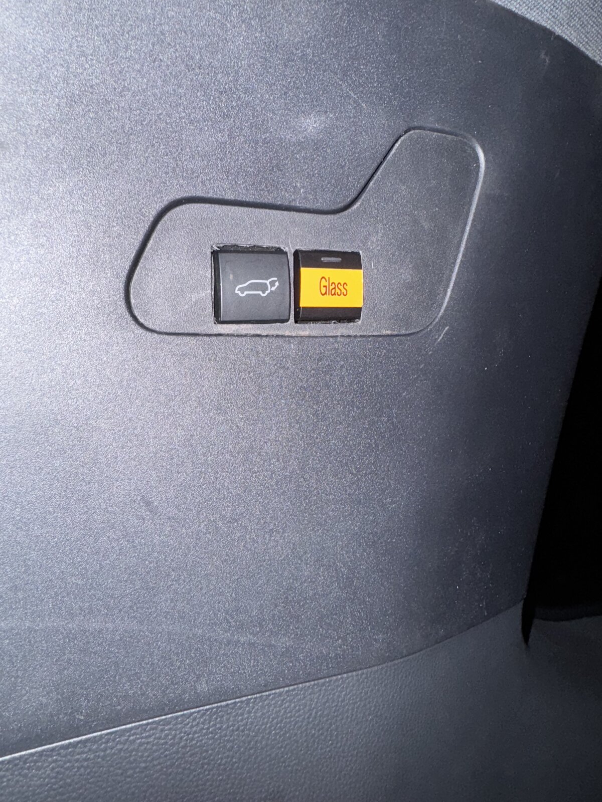

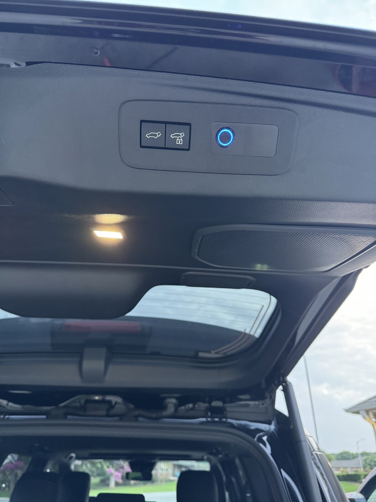

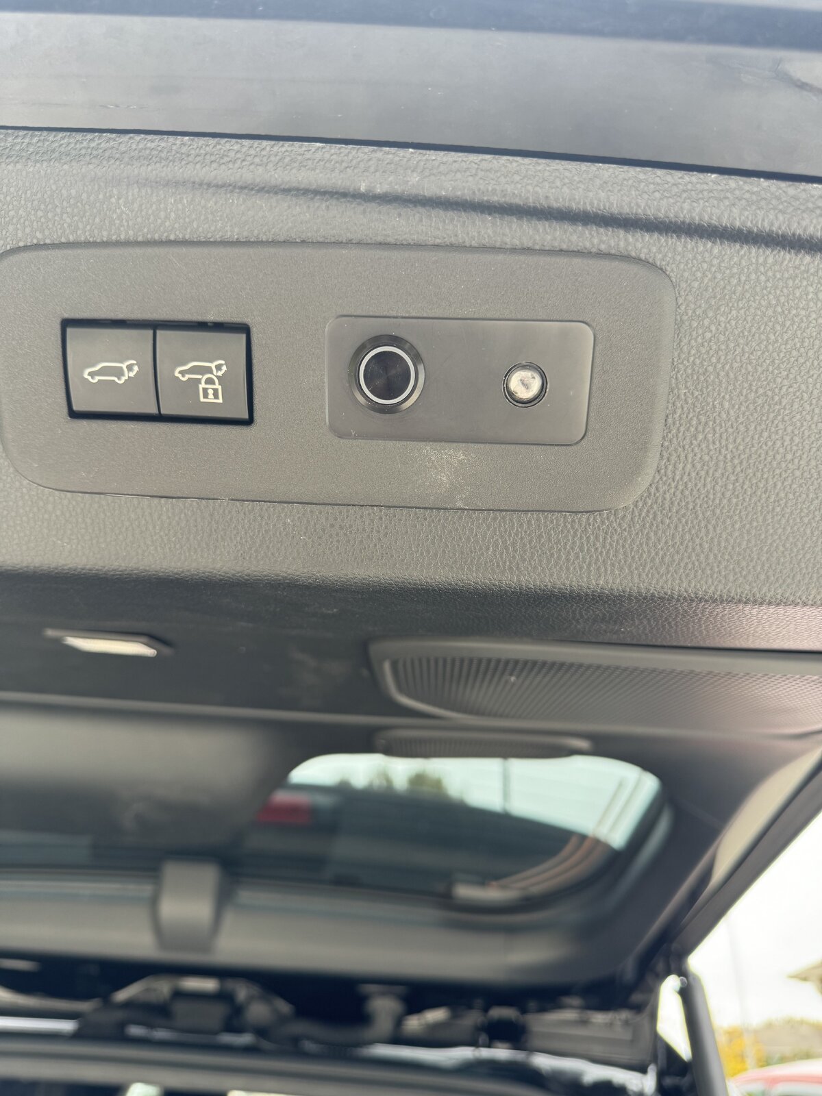

I have never seen an after-market "cube" switch socket that you could graft on to a panel for sale.
I have done this many times with various style switches and have always use an OEM trim panel that I cut the "socket" out of then plastic welded it to the underside of the panel. Some older Tacomas and Camerys use the "cube" switches for certain functions and the panels can be purchased for a reasonable price. To be honest they didn't look near as good as a flush mounted round switch. below are two examples of what I'm talking about.

Love that hatch switch in the back. With the Key Card I don’t have a hatch switch in the back when sleeping and that would be a nice add. Did you run that all the way up to the drivers knee panel or find somewhere closer to trigger it?
For the "hatch" .......... I made a breakout harness and sistered the dash switch, only because I had ran too many wires through the hatch boot. For the Glass switch (far easier mod) I ran two new wires through the hatch boot to the glass lock and "posi-tapped" the wires. (details are on my build page).
