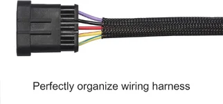

well it is far easier if you use an aftermkt Roof rack you can wire loom the wires and run it from the front to the back along the outside rails of the roof rack. I like to run everything in braided loom like this with heat shrink on the ends to finish it up! looks professional and protects all of the wires.
