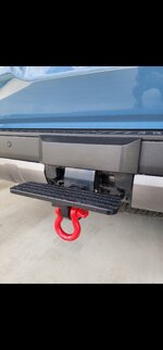

Better than my metal one..lol. I added a hitch step I use to reach the back.
