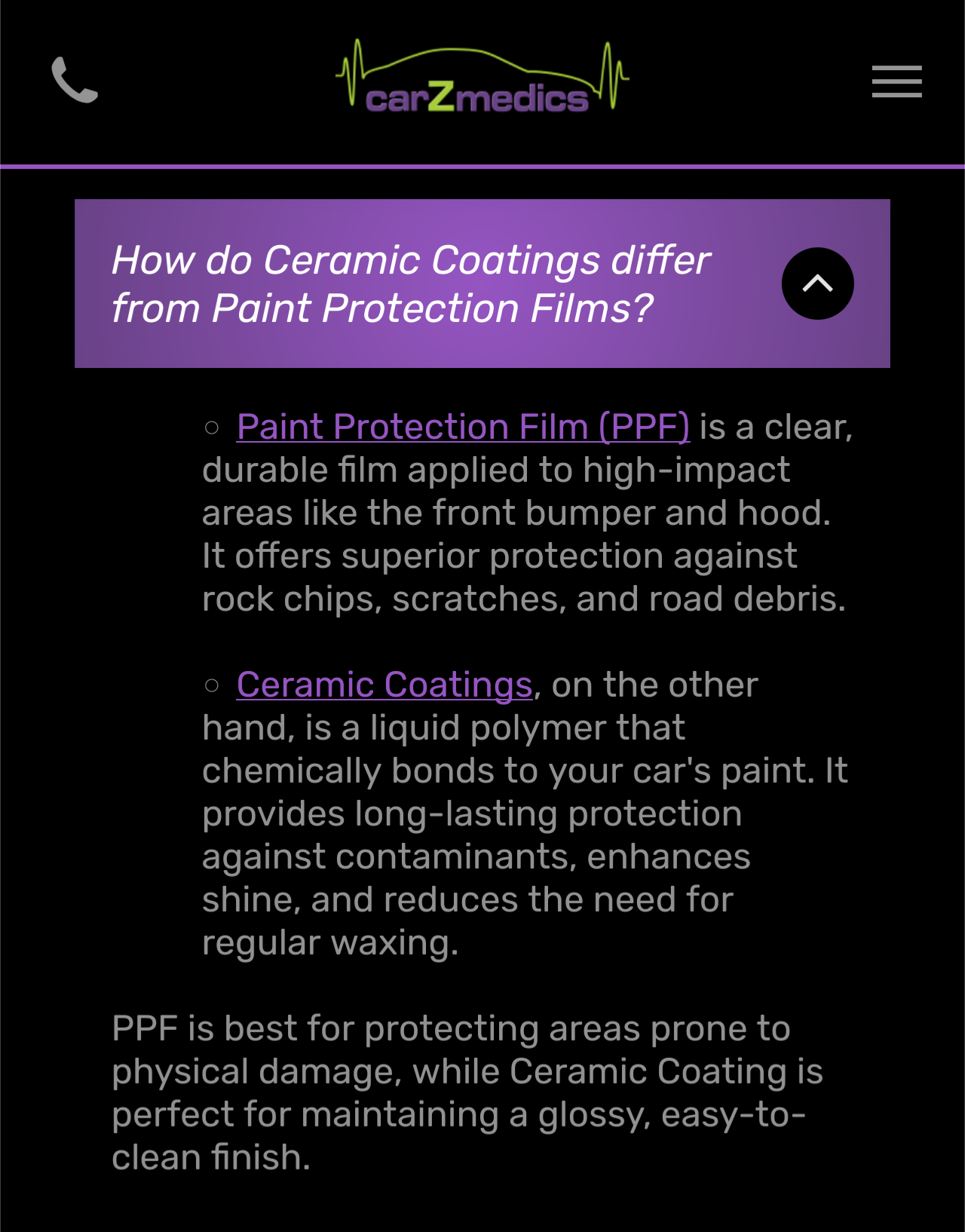

The website for the shop you used spells out the difference.

I am aware of the difference between the two products. And he is aware of why I came to him in the first place. We had a long conversation about the advantages/disadvantages of both.
