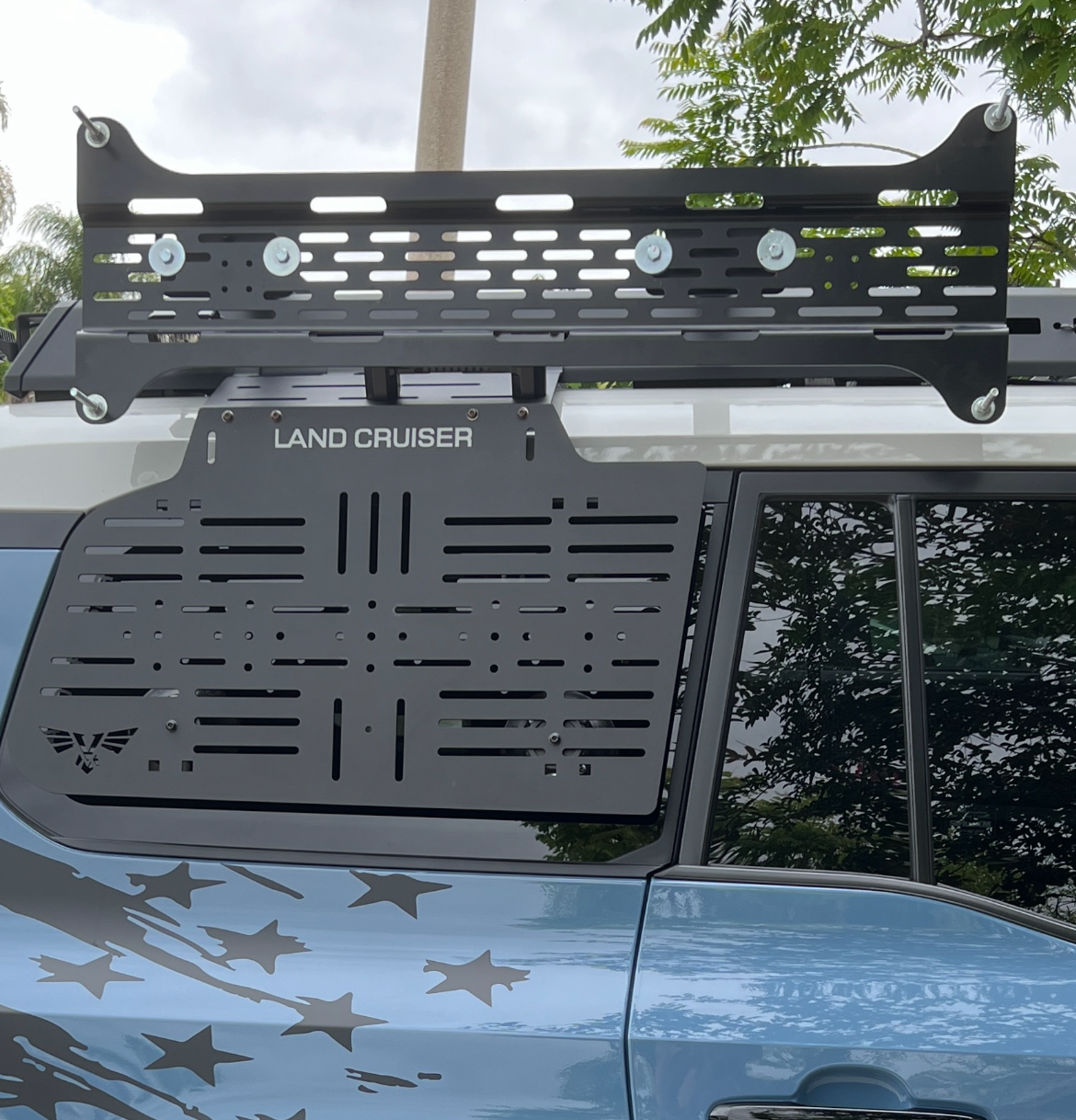

Mount this plate to cross bars, then maxtrax boards on top.
Similar like this, but mount it on top ( cross bars)

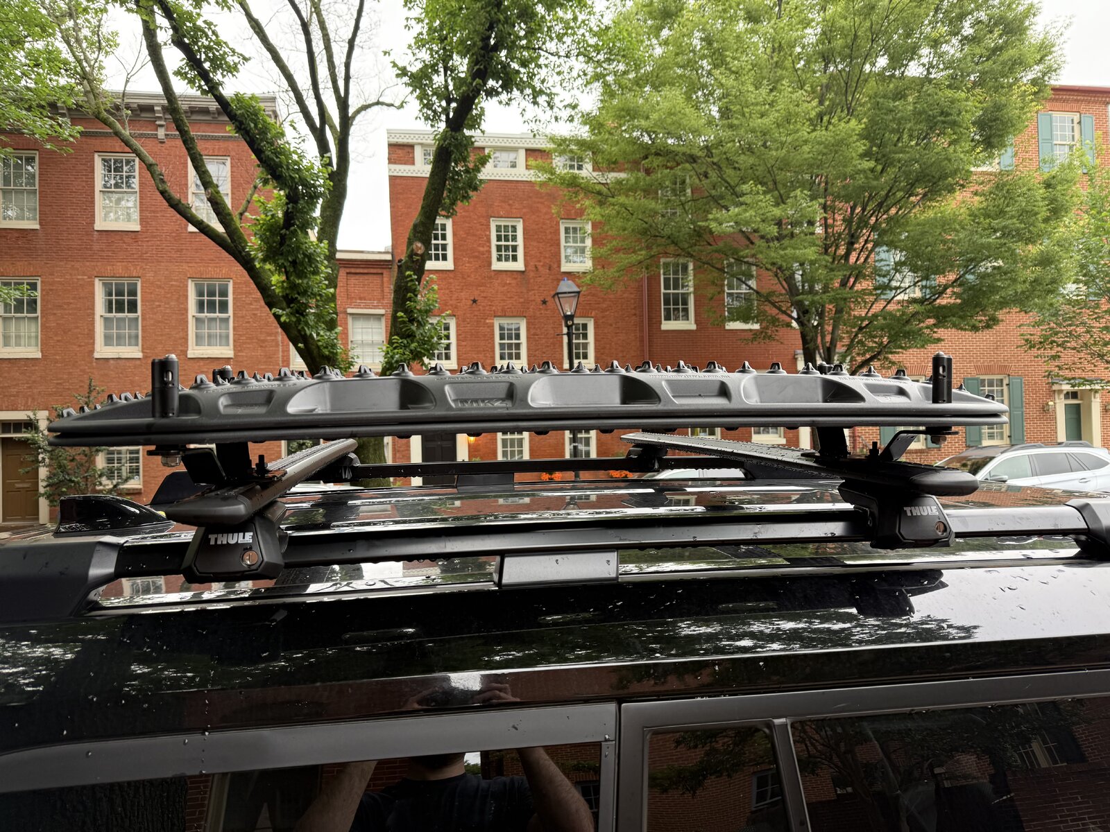

Thanks for the idea and pointing me in this direction. I ended up going with a slightly different mount from Overland Kitted. I wanted to have something that allowed a little wider spacing so I could also fit a Thule Force XL roof box up there. I went with these:
Other parts needed:
T-Slot Bolts: https://www.amazon.com/dp/B0CGB1R63J?ref=ppx_yo2ov_dt_b_fed_asin_title&th=1
Maxtrax Mount Pins: https://www.amazon.com/dp/B0CQKP1HN4?ref=ppx_yo2ov_dt_b_fed_asin_title&th=1
Maxtrax Lock: Amazon.com
I also removed the OEM cross bars and switched to the Thule WingBar Evo 50in which allow mounting across the whole bar and increased dynamic load:
Worked out great and allows me to get the roof box and maxtrax up there no problem.
