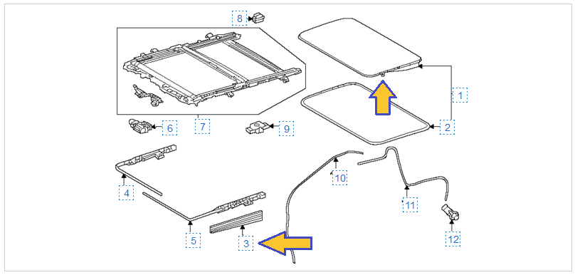

Looks like it's put together like most modern sunroofs. You can pull that accordion piece towards the inside of the car, it just clips into place. Retract the roof shade all the way and you'll see where that accordion piece is exposed in the back and can get a finger behind it.
Bolts that hold the glass in are now exposed. Tap on the glass again and see if the problem gets louder. If it's really coming from the glass mounting points, you should hear it more clearly now that the accordion piece is out of the way.
These are the bolts that fine-tune the alignment of the glass relative to the body. Not unthinkable someone forgot to tighten one during the alignment process.

I was a little bit afraid of pulling out the accordion skirt (did a quick Youtube, someone called it that way, lol), but it wasn't too bad. 2 bolts were exposed on each side. Tried to tighten them but they were all very tight. The image shows what one of the bolt looks like.
It does seem like the noise is coming from the front of moonroof, can't really tell exactly where but sounded like glass was touching metal.
