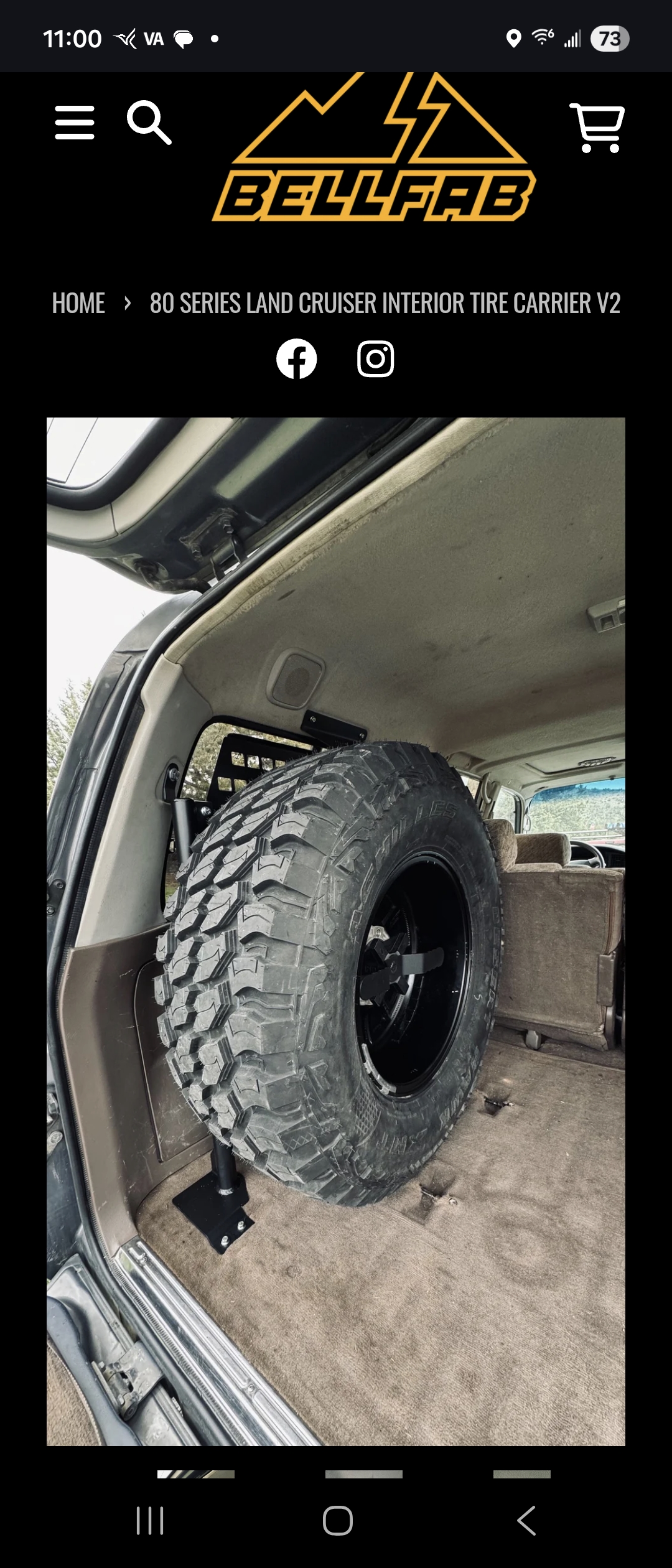

So, im not a fan of having a rear tire carrier, both look and function wise. Obviously an oversized tired won't fit in the spare tire location (also want an auxiliary tank mounted there when they're available).
Anyone know of an interior spare tire mount similar to that, that Bellfab makes? If not, will someone make me one please 🙏 😂

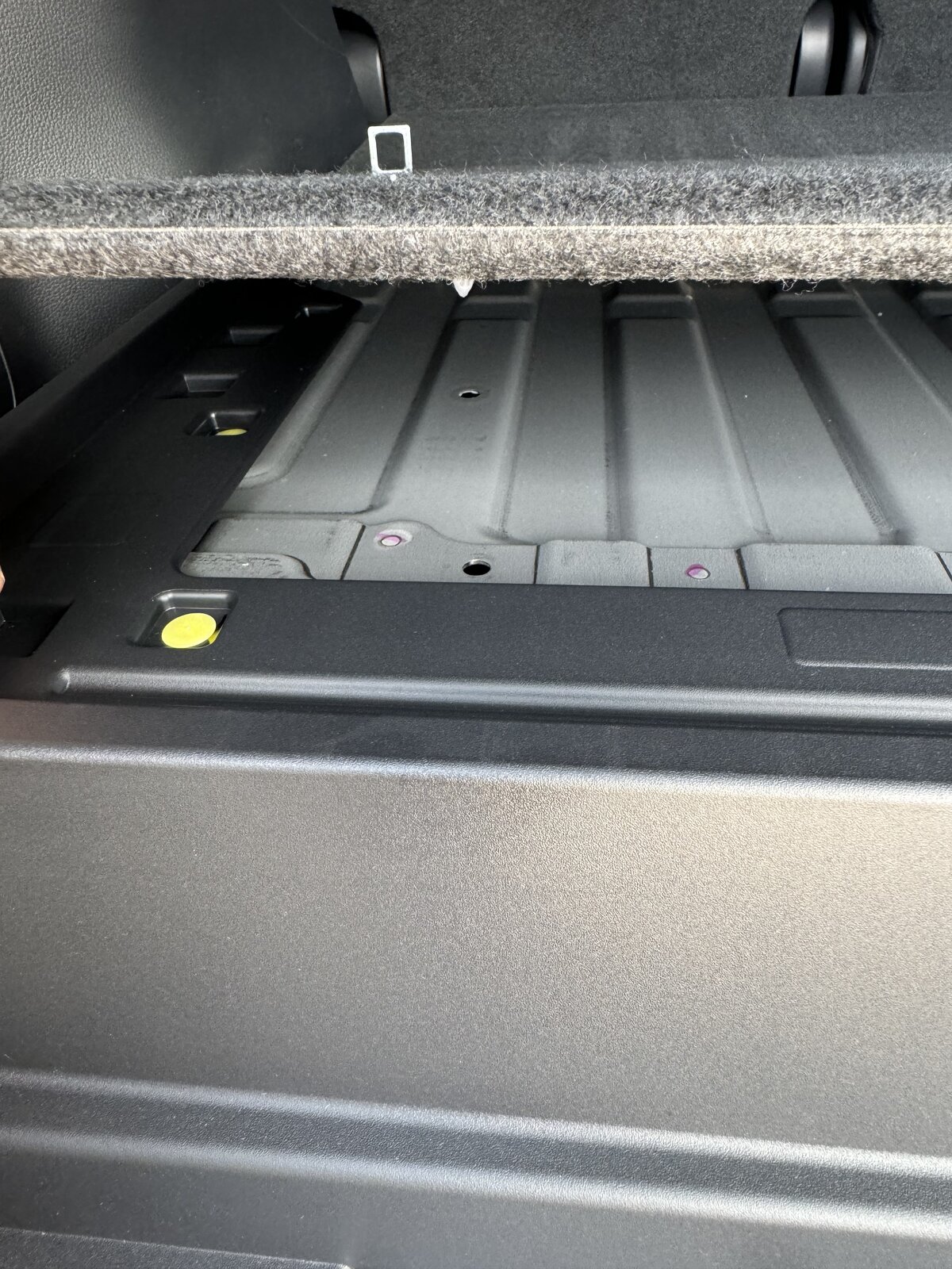

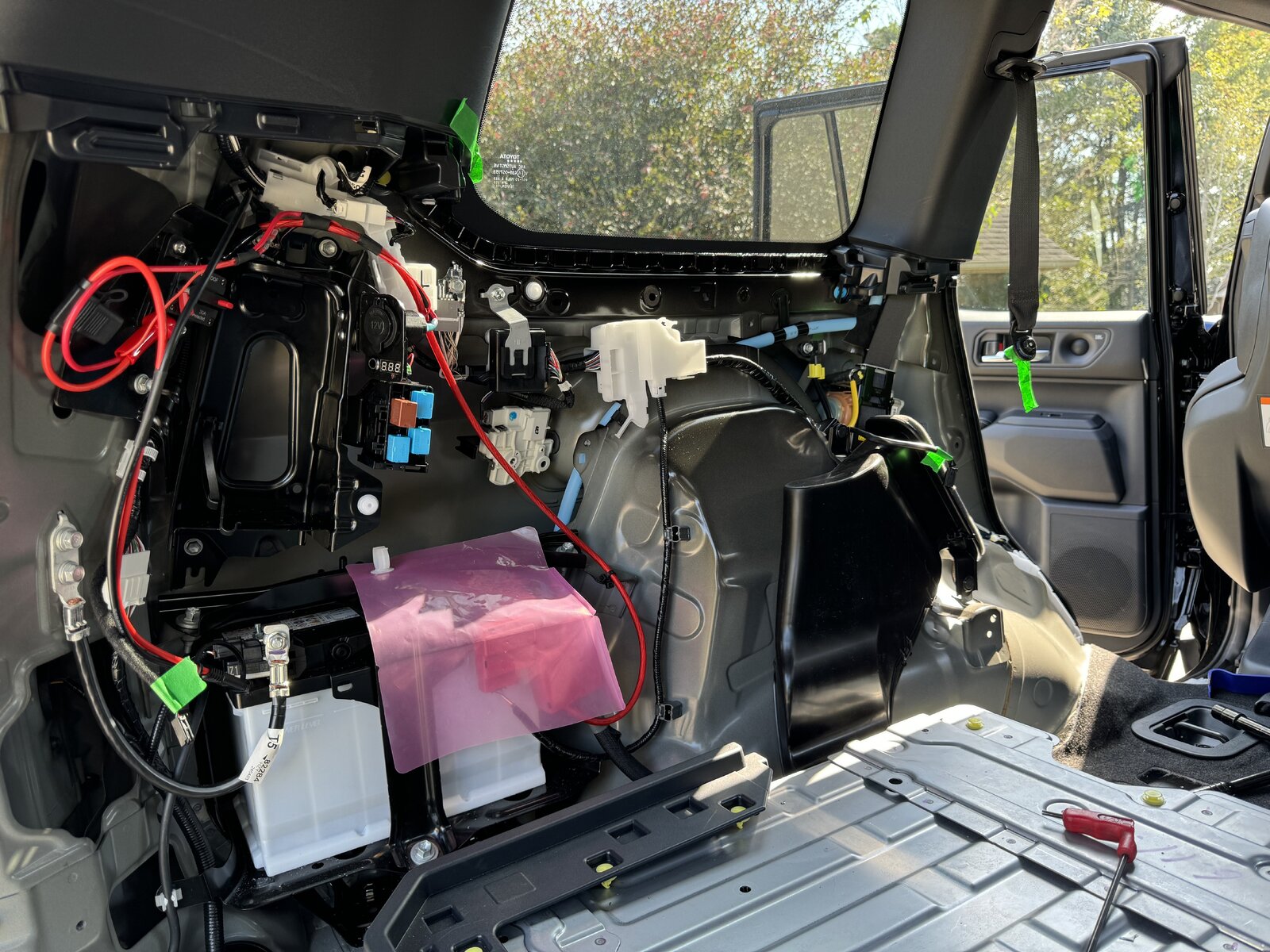

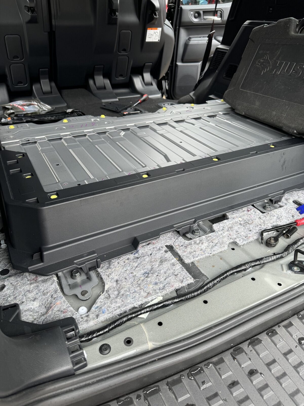

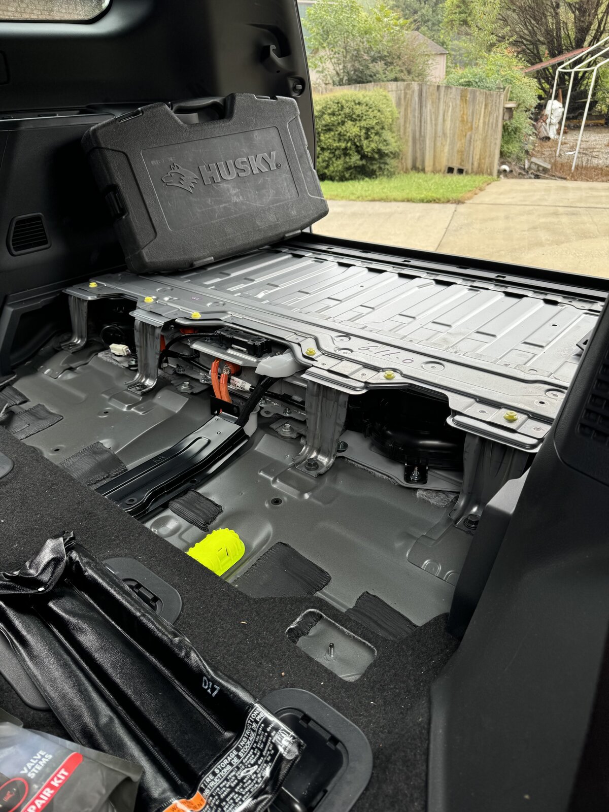

While it would be possible to fab a mount in that location, it would require a lot of compromise on the existing storage spaces and probably require the mounts removal to replace the 12v battery. (something to keep in mind during your design process) There just aren't many solid body attachment points without cutting into the cargo floor panel.

Thanks for the photos, really helps me get a good look. I haven't actually got in the back to check the viability of having a spare mounted. I'm guessing based on these photos the floorboard clips in the back are not attached to the main body?

The actual Hybrid battery is bolted to the cargo floor and the metal cover (you see in the pictures) is bolted over the battery, to the cargo floor. There are fans, wiring etc...... also under the cover. Then the cargo padded floor is Bolted and plastic fastener, to the battery cover.
If I were going to fab an inside "upright" mount..... I would fab some posts utilizing the existing factory bolts/threaded holes, that would be just tall enough to end at the underside of the existing cargo padded floor. Take an 1/8" thick plate (place the tire on top to get the general ideal of width and length) and through bolt it to the posts, along with some "nut zerts" in the battery cover (insuring the nuts zerts wouldn't interfere with anything) Then build an "A" frame from that base. Then attach a brace from the jack cradle to the rear of the "A" frame at lug nut height.
But without actually taking the trim panels off and measuring and seeing how much fabrication would be needed, I don't know if this approach is feasible.
Lastly, I would attach a safety cable through bolted to the floor so that if a rollover occurred, I wouldn't have to dance the tango with the spare tire.......LOL
If I just wanted the spare inside..... build a platform with enough room underneath for the spare to lay flat. And probably put the entire thing on sliders.

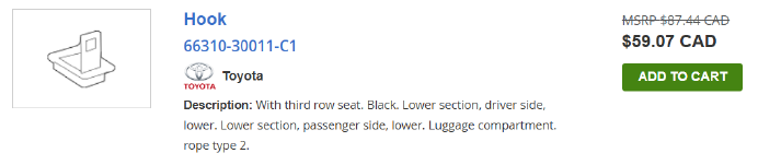

The most important thing, IMO, would be securing what ever mount to the floor and preventing it from horizontal movement of the rather heavy tire/wheel and ripping the entire mount from the floor. That could be accomplished with a tube from the jack cradle, but would require a hole in the jack trim panel and permanent evidence or a new trim piece should you ever decide to sell. Should you decide on a platform you could order 2 additional OEM tiedown points and fit them in etc.....
