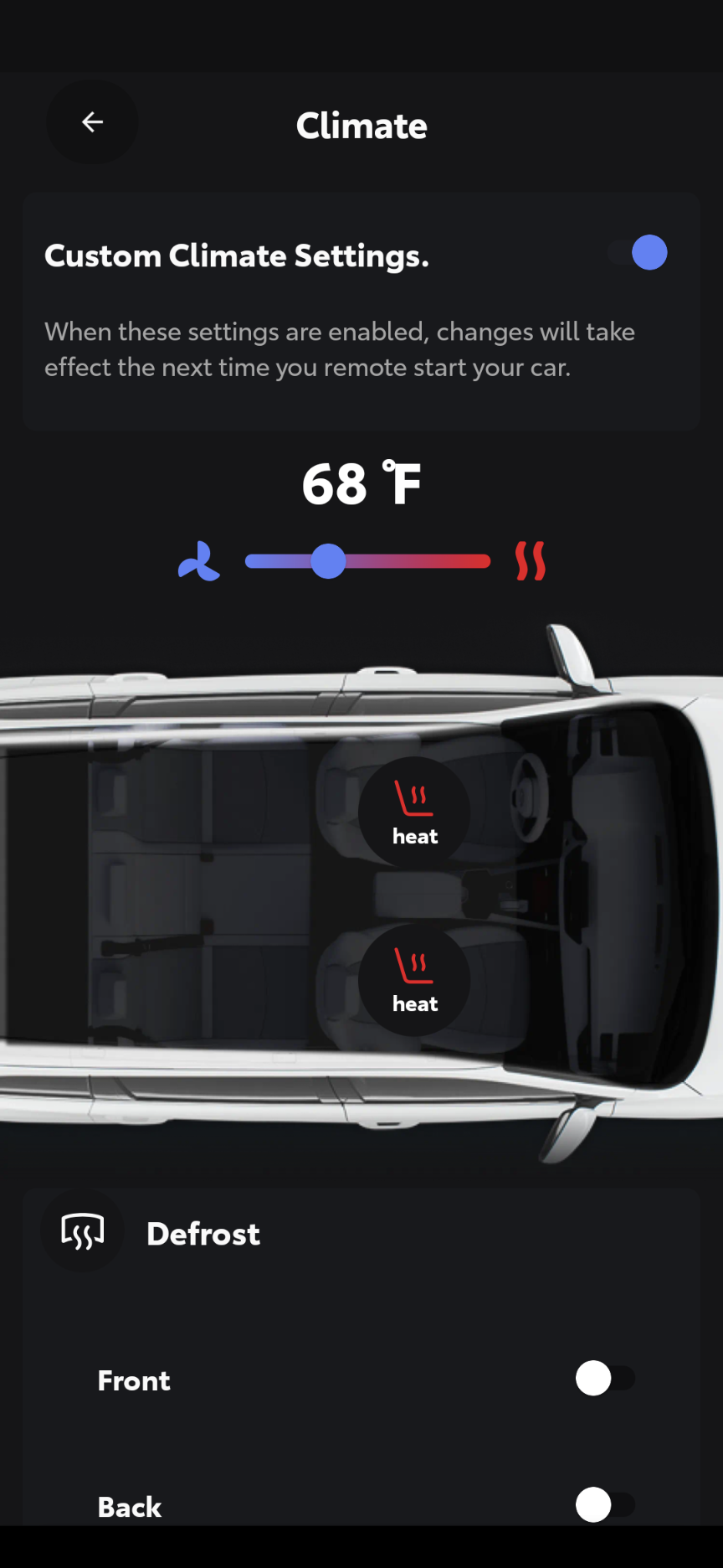

How i got to that screen:
1) open toyota app
2) from the initial screen with the car at the bottom high-lighted and the remote tab active
3) swipe up to get the screen with light, hazards, climate, buzzer, etc
4) click climate
5) enable custom climate settings
6) all those options appear
7) click save at the bottom so the changes persist
Ah Toyota and your app. I'm also on Android and those options don't show up for me. I guess it's time for a call to Toyota's engagement center.
