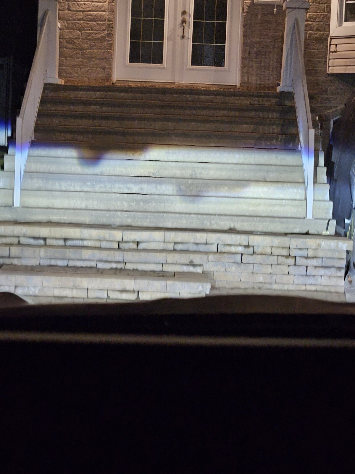

The left front headlight has that uneven "W" projection on my LC 1958.
Is that normal? I took it to the dealership and they've been surprised too and don't have much experience with this new vehicle.
They said that they contacted Toyota, but haven't heard back from them yet...
It looks like your right headlight is much lower than then left one.
Yea they've adjusted that at another dealer. The first dealer did a complete mess "trying to fix the W" so they raised the headlights so high that it felt like I was driving a ww2 searchlight.
how do I get rid of the W pattern?
Adjust the lights up. Mine were pretty low from the dealer, I got a little too aggressive and started getting flashed, so moved them down a bit. I still see it sometimes (I have the square lights), you get used to it.
*funny enough, the people flashing me were full size trucks, not cars lol.

Good info, BUT JUST TO BE CLEAR: This should be used if your headlights are legitimately out of alignment, and is NOT how to "fix" or "get rid of the 'W' pattern" or notch in the beam.
That pattern is intentional, and not a bug or something wrong with your headlights. Trying to adjust the height or direction of the beam as outlined in the quoted post above MAY (or may not) make the pattern change or go away, however you'll likely also be creating additional issues either for yourself or on-coming traffic if your headlights aren't aligned properly as intended.
I too had an issue with this when first purchased ( 2025 model). My dealership could not explain why, but after working with them adjusted headlights . The “w” is still there but coverage / range of headlights greatly improved. Still no real answer as to the purpose. The oncoming traffic explanation makes sense, but why the mystery?

Trying to re-align your headlights to get rid of the notched pattern likely only reduces the intended effectiveness of your own headlight's field of illumination and/or makes them more distracting or hazardous to oncoming traffic.
I used a socket (can't remember which mm)instead of a screwdriver, the "W" cut off aside, my lights were way too low from the factory. I've gotten used to the "W" cut off, it isn't that big a deal after a while.
