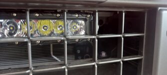

Here is build I am
getting it done. But my harness got chaffed. So a waiting game to get all the wired getting crimped with connectors.
The brackets for fog lights I will share soon. Meanwhile I am working on the radiator lower section behind the 2nd Cam which guides the I believe thr Fully Auto Adaptive Cruise Control. This would be the Baja Onyx6+ Design( Here is what I am trying to get the Color sorted out Yellow or White) Bit confused. Here the bracket Assy is customised. It would be at 120 Deg bolted to the OEM Radiator Supports.. A Flat Angled Running the entire length. A T bracket bolted to the OEM support Mid Section support Bracket( OEM) already avbl. You will see the first three snipped are the LH& RH and Mid side view. . And then how the build going to be post build. I am trying to decide whether to go for 6 or 10 or 12. My worry is the Lower Cam connectors would melt or burn out of the heat when illumunating of such lumens. I am not rushing. Making a well research to last a long time and not ripping it often.

My car is currently in the shop getting scanned for some custom mods, BUT... from the pictures he shared, it looks exactly like what i have mounted and even done at the same shop. He is referring to Baja lights, but shows a Stedi bar in the pictures... I have no issues with the 21" slim Stedi lightbar bouncing around and it is very VERY sturdy. Will share some pictures later today, else tomorrow when i have the vehicle back. but here is a front view so long :)
