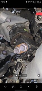

The diesel variant in other markets use fluid type engine mounts yet the engine vibrations are noticeable in the cabin while stopped or under low speed conditions.
