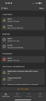

Have anybody seen this code on your LC?
I just had this code coming up after I refuel at almost empty tank at meter (I had roughly 20 miles left on the display)
Now I tried to reset the code and start driving again, hopefully it is just a glitch but it now shows as a permanent code in my EMC. I am driving to the dealer for a check up too

It is a code related air/fuel mixture that the engine is creating. To lean means that there is too much air compared to the amount of fuel being injected.
It probably happens as the ECU is trying to tune the mixture, possibly due to new fuel having different properties. You can ignore it.

Have anybody diagnose this type of issue before? I would try to record these sensor reading later but don’t know what is the normal range of values
