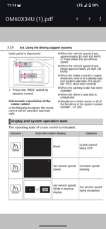

Correct, I'd recommend doing what the message says and read the owners manual :).
Well, you are correct sir. Kinda just glazed over that the when I read it. As if it wasn’t important. It worked this morning. Appreciate it.
