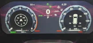

I hear you ...this is my 1st vehicle with tire pressure sensors and I selected that gauge for one of my multi-information display screens. Pressure shown matches my cheapo tire gauge. Looks like my spare is super inflated too!
