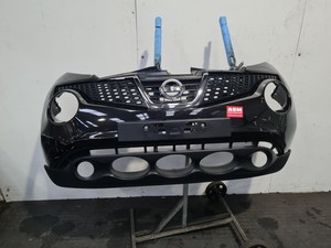

I see this problematic, has anyone owned or known someone who owned a Nissan Juke? I used to, and I was on a Juke forum discussing this vulnerable front-end.
If stones came barreling towards that lower valance, your radiator got smashed and started leaking...

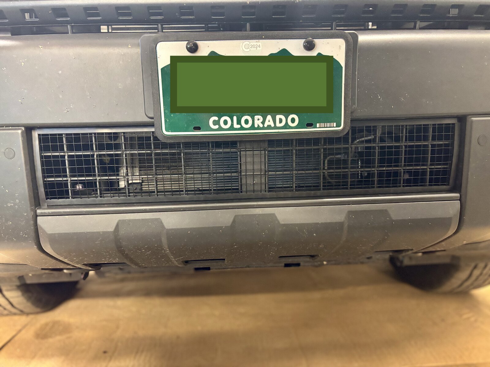

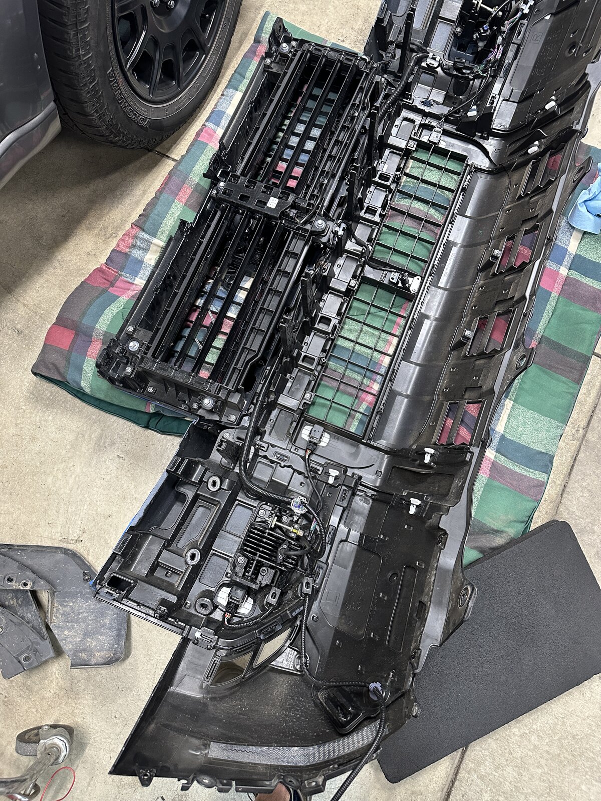

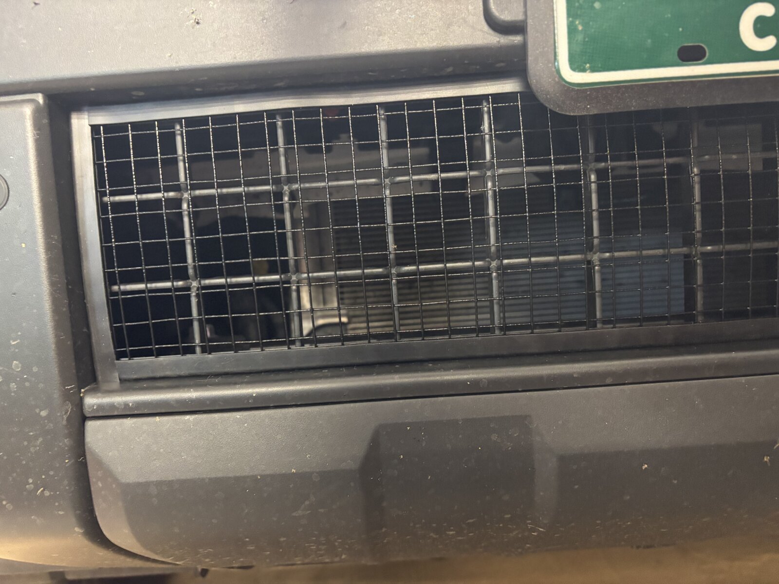

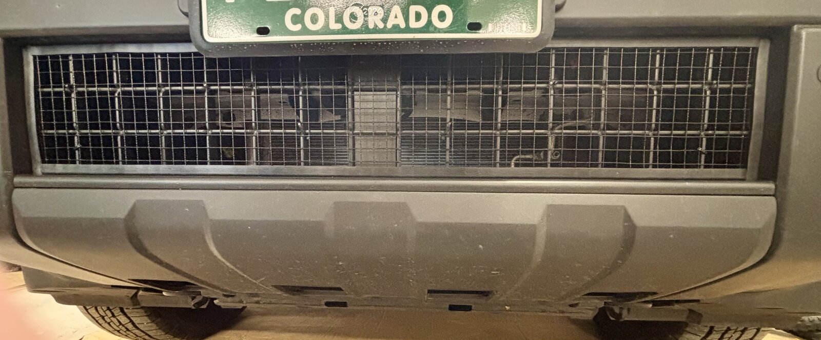

It took me about $25 of material and 20 min of snipping and clipping to come up with a quick and dirty stone catcher. The grid size of the LC grill has 2" openings, #57 stone can easily pass through. I used 1/2 welded wire fence with a pvc coating which seems like a good size to catch the stones and debris that may cause more significant damage to the rad. without blocking too much air flow or be prone to filling up with snow in the winter time. Once I clean up the rubber stripping to make it look a little more clean, I plan on using six to eight 4" zip ties to keep things tidy.
