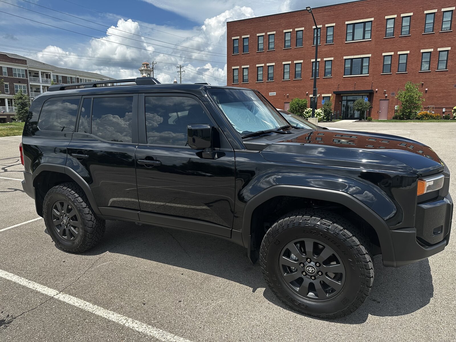

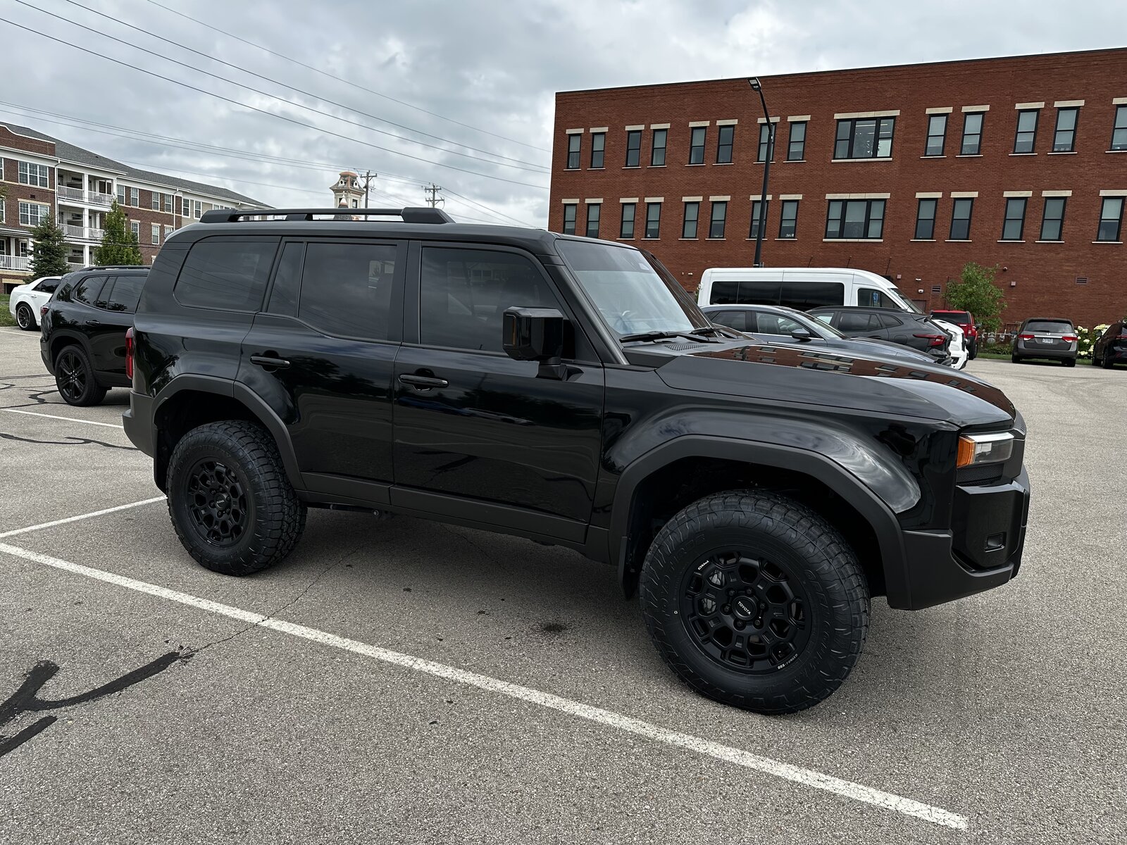

Completed so far:
- Lift: 2” Lift- Front C59-882 springs w/GS59-660 shocks; Rear C59-817 springs w/ Bilstein 5100 shocks (probably going to change these at some point)
- Cosmetic/Interior: Tri-color grill badge (Y/O/R), ceramic tinted windows, 6 year ceramic coating, rear hatch light, Hella horns (the stockers sound like my Ducati, lol), center storage organizer
- Wheels/Tires: Stock wheels are gone, as are the 275/70/18 Genral’s - I really did not like those tires. I have gone to TRD Pro BBS’s, w/285/70/18 Toyo AT3’s…my third set of these (others on my truck), and like the others, they balanced without little to no weight, and ride well, limited noise. I expect they will wear as evenly as the current ones on my truck, and the previous set I had on there. I have close to a 34” tire, a tad more weight that the General’s, and not as much as 35”s, so I am good.

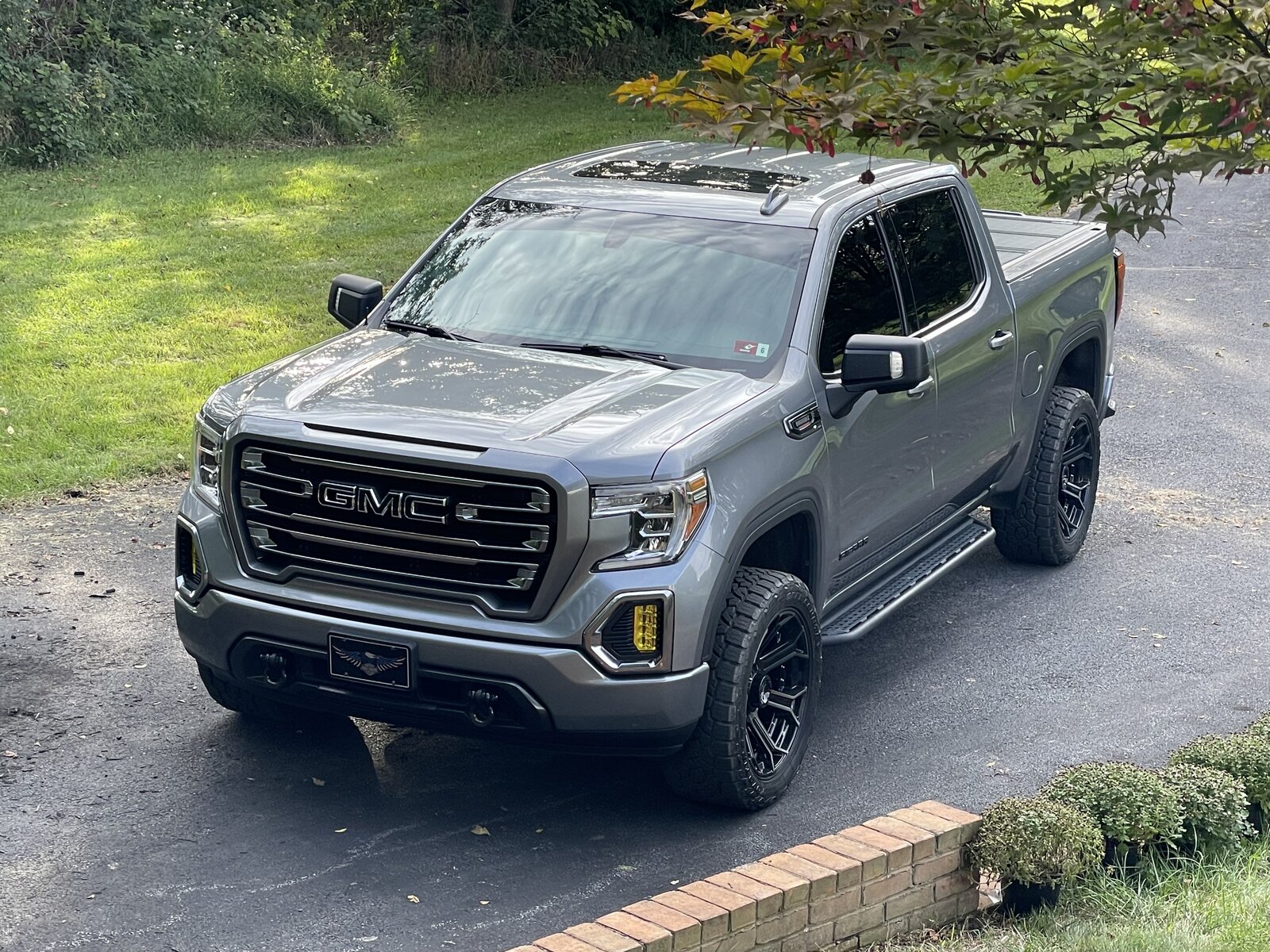

Toyo’s on my truck for reference:
