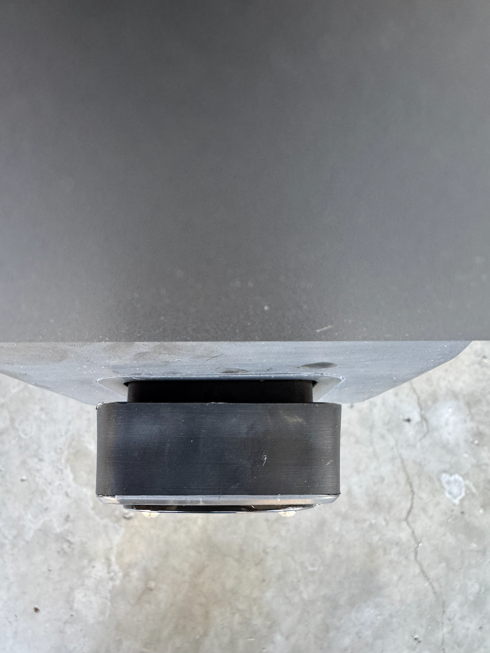

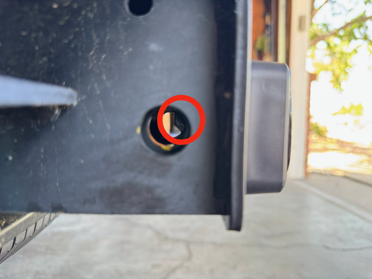

I received my Baja Designs S1 Reverse Light kit today, figured I'd get to installing it. Very very easy but I did run into a small issue. The plastic mount that comes in the kit does not sit flush to the receiver due to the light heat dissipation fins. There's maybe a 1/4" gap between the housing and the receiver, not a game stopper by any means just not what I expected. I had to bore out the hole a bit more and now it fits. Pictures below along with the video that I watched prior to buying it.
Yes, I know it's a "universal" kit and I'm fine with how it is, stoopid bright even mid day!

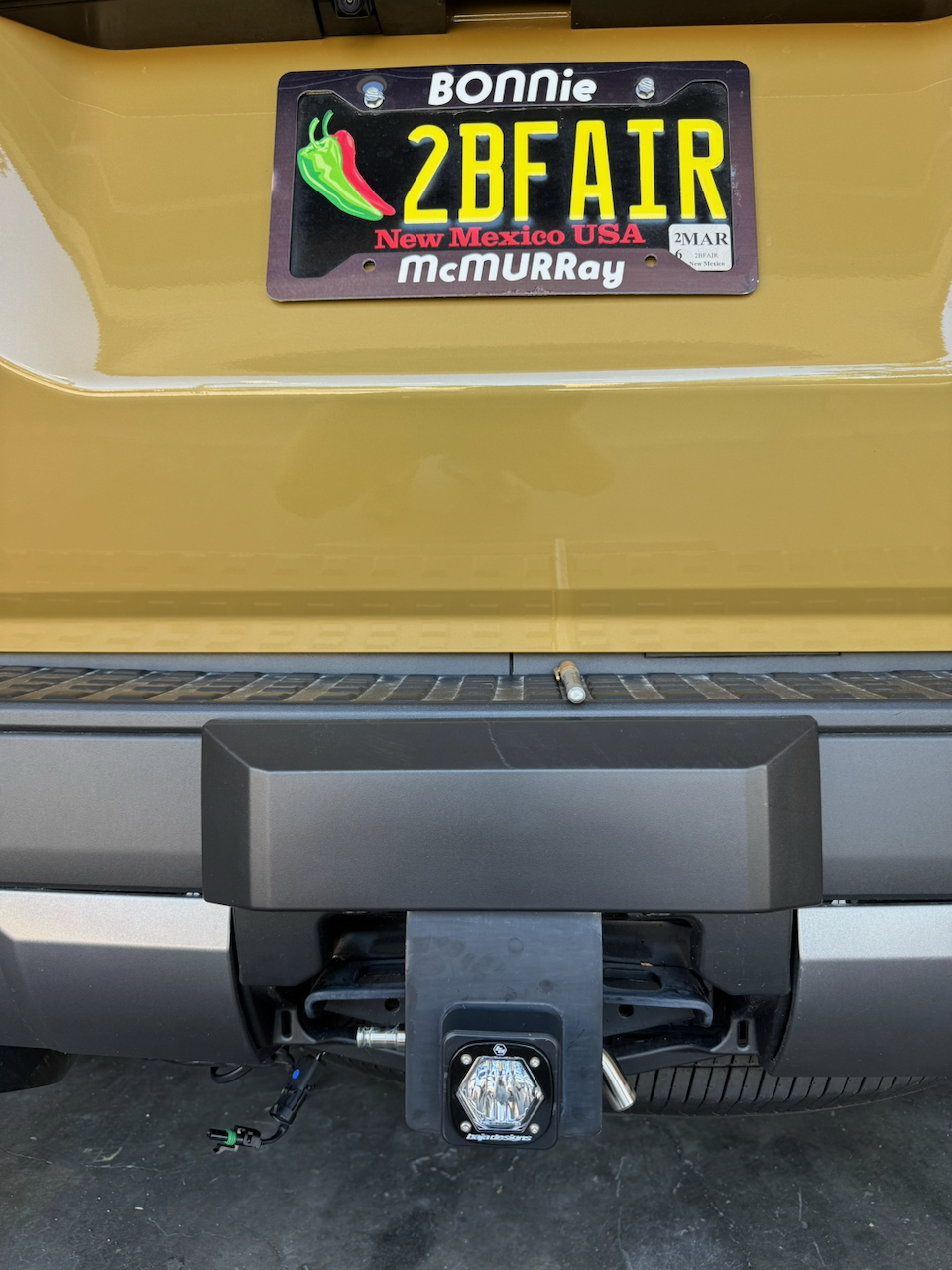

Installed
Top down view showing the gap

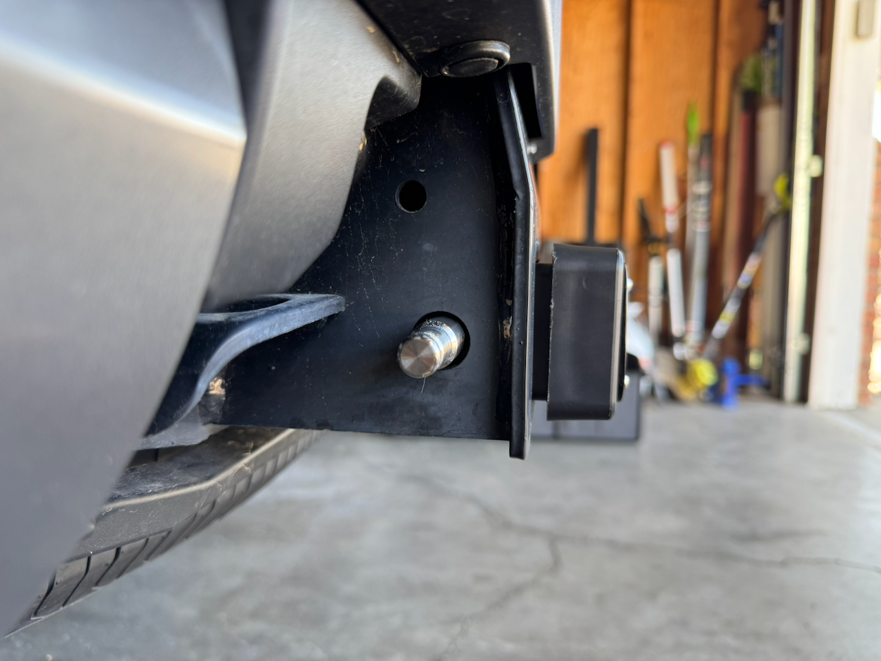

Side view of the gap (fully installed)

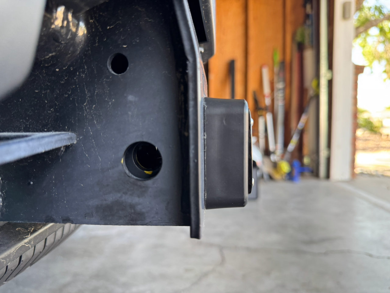

The problem aka heat fins are in the way!
