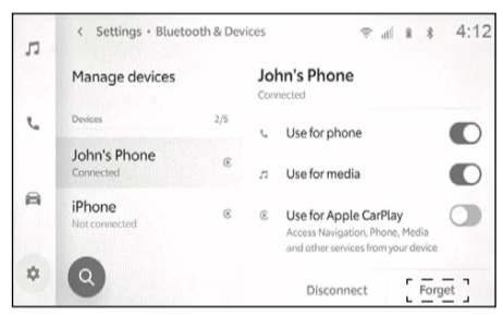

I’ve been trying to work out if there is a trigger for the way apple car play connects to my 24 LC. Sometime I start the vehicle and it displays my ca play screen automatically. Other times it loads the Toyota interface and I have to hit the car play button. I have not been able to figure out how to connect to car play after getting in the vehicle from remote starting with out restarting. Anybody have insight?
After a remote start you get in your car and you push the start button and you have to go into your screen and reenable CarPlay under settings, Bluetooth and devices.

I had the same issue. You have to delete the other iPhone from the Bluetooth device list. There can only be one. Now, Apple CarPlay starts automatically every time I start the car. My wife created her own Toyota profile and paired her phone under her profile.
