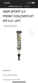

Looking for feedback from anyone that’s tried the Radflo coilovers specifically the 500R Sport 2.0 front coilovers and rear shocks.
I’m interested in this set up because I’m looking to level the LC and add minimal to zero lift to the rear. Garage height limitations. I also don’t need reservoirs as my use isn’t anything taxing or extreme.
Interested in feedback on how it affects performance on and off-road compared to stock. As well as ease of height adjustment. Thanks!

Radflo has both 2.0 and 2.5" non-reservoir IFP coilovers as pictured that I was looking into also. I like that Radflo builds to order, and is willing to customize. It seems the Dobinsons or Old Man Emu are more popular for LCs at the moment. I suspect Bilstein and Fox will also become common upgrades in the future, especially if they are sold at dealers as TRD parts.
