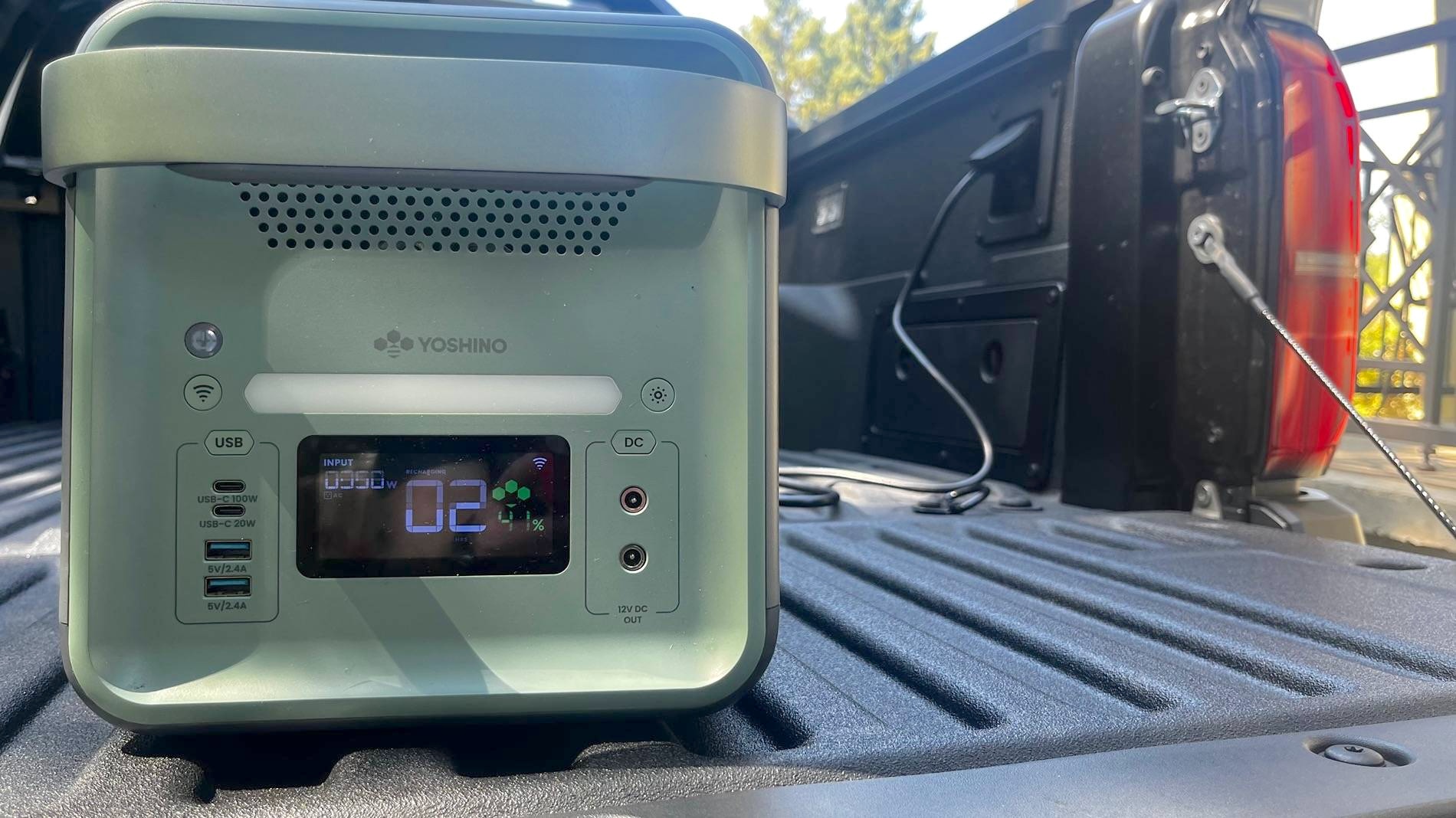

Check out the Ed Martin Toyota video. The new Ecoflow Delta 3 1000W battery bank is a nice combination of size, capacity, features and cost but there are other brands like Bluetti, Anker, and Jackery that are similar. Just make sure you get the latest generation from this fall.

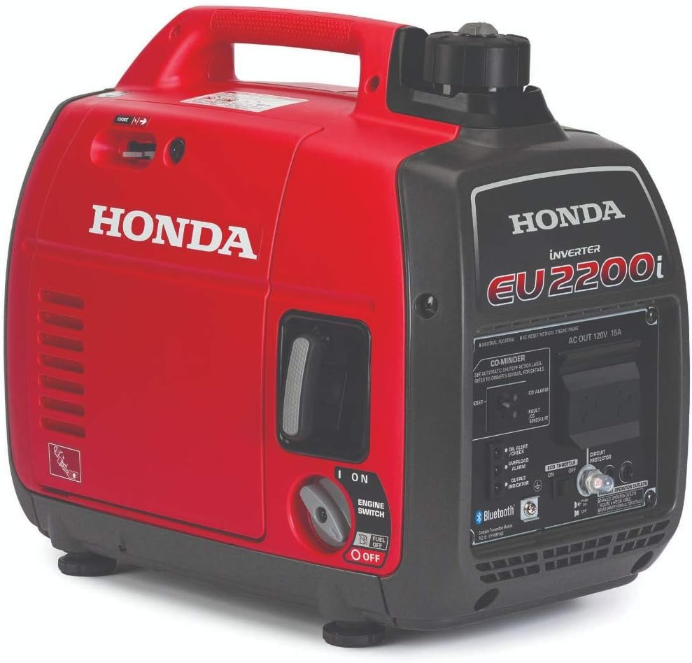

A Honda Silent gen, 2kw or a bit more, about 1200$ on AMZ.
If you want to use the vehicle inverter the engine cycles on and off to keep the battery pack charged.
It runs off the DC motor battery pack.
Keep your loads around 2kw and you should not have any issues.
Learn more about how the systems work to avoid issues as well.
A small separate gen set is a good way to start if your unsure and alone.

The nice thing about the battery banks like the Ecoflow Delta 3 Plus is it can fast charge at 1800 watts in only about 30-45 mins off the Land Cruiser inverter.
It is also supports simultaneous dual sourcing from AC and solar. The LC inverter is a better solution to the DC alternator chargers some brands offer.
Additionally, the Delta 3 Plus has pass through mode where it maintains the charge level or different managed modes where it draws down the battery to a specified level and then recharges back based on a schedule or policy.

Here are a few other benefits of a high quality battery bank:
1. It provides pure sign wave power which is required for certain types of devices with sensitive electronics
2. It better handles and insolates the LC inverter from spikes coming off the devices which can surge at start up etc.
3. You can move the battery bank away from the vehicle onto a table, near a tent, or into your house.
4. The battery bank provides fan out with more and different types of outlets to plug in devices. (AC, DC, USBs)
5. The battery bank is essentially silent when not being charged by the LC inverter.
Basically, the concept is you run everything off the portable battery bank and use the LC inverter when needed to keep it charged..
