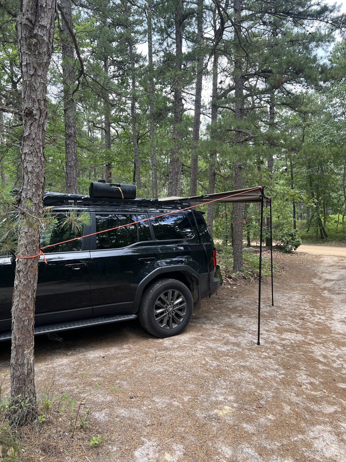

I mounted on a Greenlane rack.
No roof rack needed. Just mount some brackets to the mounting points and attach the awning to it.
Looks great, @mikemann313 ! Are you able to fully open the rear hatch, or do you have to set a lower opening height?
Also, is that the Rhino Rack Reconn Platform rack? How do you like it?
Sorry for the delay — Rack is the Reconn, and I’m a fan. You have to tap all of the horizontal cross bars, which can be tedious, but it is lightweight, and holds plenty of stuff. I’ve got Recovery Boards, the 270 BW, a 5 Gal waterport, WeBoost and switch between storage box / gear racks (ski/boards, kayak, etc.).

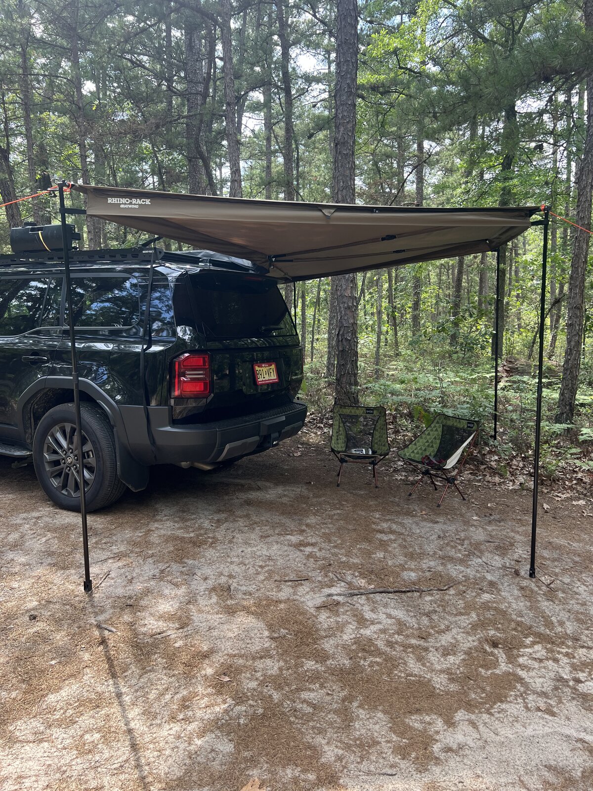

The rear hatch doesn’t go up all the way without touching and getting impeded by the awning. I think that Rhino Rack makes extension poles to go higher which would potentially help, but I am getting by with a lower opening for now. Other things I was considering was removing the spoiler, everything opens fine if the spoiler weren’t there.
Adding a couple more trips pictures with the awning. Klymit makes inflatable light tubes that I’m going to try to integrate into the awning, they deflate flat and I’m thinking could work well on the cross-beams. I know the ARB awnings come with lighting built in, which is a nice feature… but maybe I can use what I’ve got to make a poor mans integrated lighting awning...
